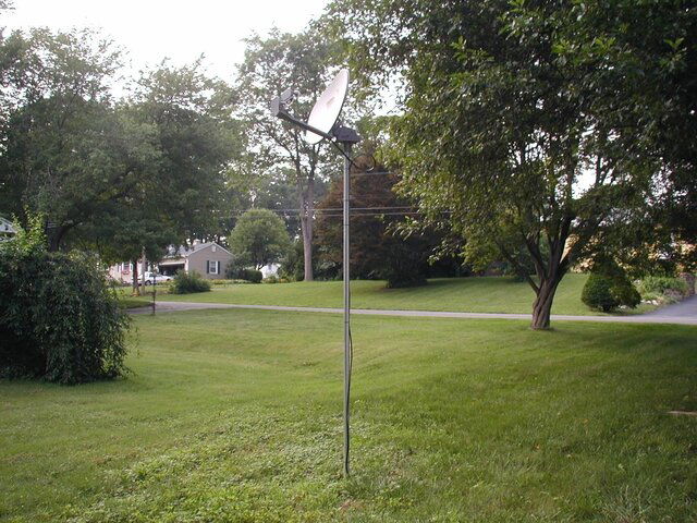

Sure, here you go. This is before I switched out to the Slimline.
Wow! That babies really up there....haha That has to sway with a little wind. Our poles are 6ft long with three feet in the ground. If you dont feel like cementing it there is another option. You can use an old footing from an old mount and fasten it to the bottom of the pole with 2 screws. I doubt you have any footings laying around but that is an option. I sometimes use this method when I run out of cement.

I did the install myself. It's a 12 ft pole with about 3.5 ft in the ground. I used two 50# bags of Quikrete, and there is a thru bolt in the bottom. I have NEVER lost reception in any wind, and that includes wind gusts up to 70 mph. It's been there for over four years. Any other comments?

Oh yes the old selftap the foot mont to a pole. The worst offender to poles that have to be redone. Please Please PLEASE stop doing that.
