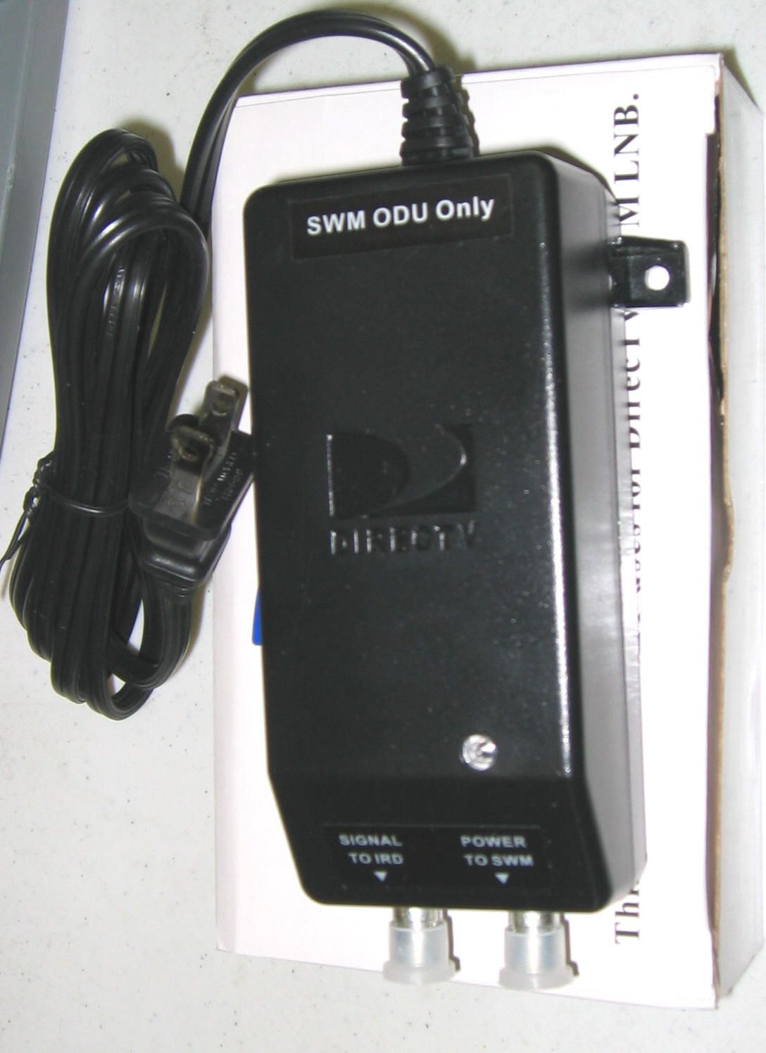

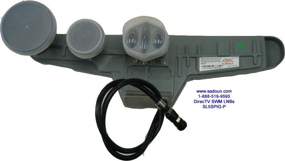

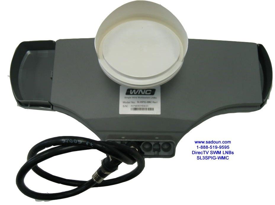

As dishrich said, you do need a 21 v. power inserter. You should unplug your receiver when hooking things up (make sure you connect the LNB and receiver to the correct ports on the power inserter). Plug in the PI first, then the receiver. It will recognize the SWM and configure itself automatically.
Make sure NOT to use the BBC. Plug the RG6 coming from the power inserter right into the back of the receiver. as long as you have the dish properly sighted in, it should work flawlessly.
The power inserters are all the same, its only the splitters that are different.
The SWM8 uses a 29 volt PI, while the SWM LNBs use a 21 volt PI. Supposedly Directv supplied 29 volt units for some early SWM LNB installations until the 21 volt type was available, so either should work in your case.
