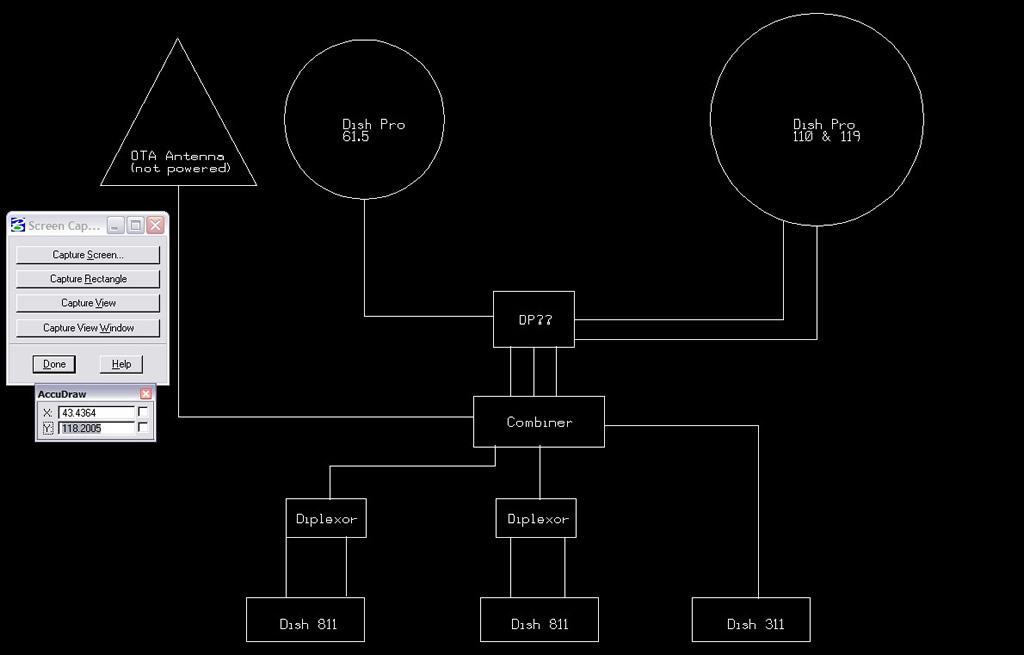

I am having voom/dish installed on saturday and would like some feedback on my attached diagram....does anyone know what dp switch they will install. I figured its all going to be dish pro equipment. Also does the rest of this look correct, is there E8 specific diplexors they will put on and if so whats the model? Thanks!
It's a waste to run the OTA to the 311. I would just use 2 diplexors of the power passing type, and hook up the antenna to each 811's line and then use 2 more diplexors at the receivers to split the signal back out. Using Power passing on both ports eliminates the need for the transformer to boost the OTA signal. Most OTAs can handle the 20Vs fine. Check your OTA manual for sure.
