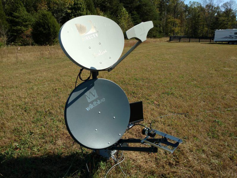

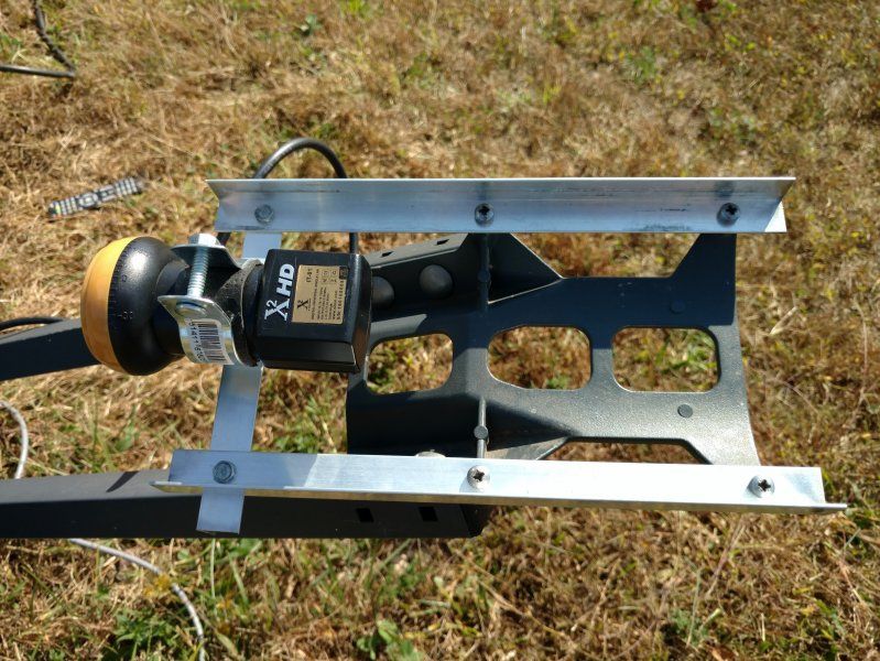

I'm Chris, located in Southern Indiana across the river from Louisville KY. I've been a dtv sub for over 10 years and started to get the itch to play with FTA. Found a old WildBlue/ViaSat dish and started about grafting on a Ku LNB to replace the Tria (Anyone need it or is it of any use). Got it mounted up a month ago and enjoyed playing with it finding a few feeds mostly directly overhead. Mounted it to a HH120 and now can swing it all over the sky. I have full H-t-H viewing on 20 acres of farm land.
Now I've purchased a GSP 90cm & HH90 and am looking at planting another pole to mount it up. My first question is the planning of my dish farm as I plan on adding a C band dish down the road. What orientation should the dish poles be aligned (south to north im assuming)? I was thinking about putting the second pole about 3-4 feet to the south of my existing pole.

A few photos of the start of a new dish farm...
When I used a Wildblue dish for FTA I found that I got a better signal when I put the sub reflector back on.
Nice setup!
Reactions: hank123
The wildblue dish didn't have a sub-reflector. I had seen other people use it with the sub and have success. Not sure what I'll use it for. Maybe for a long range wifi project down the road.

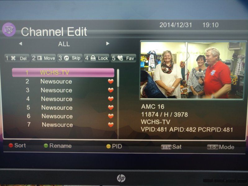

Is there anything on 85w? This is my due south and am aiming the 90cm today and can't find anything on AMC 16.

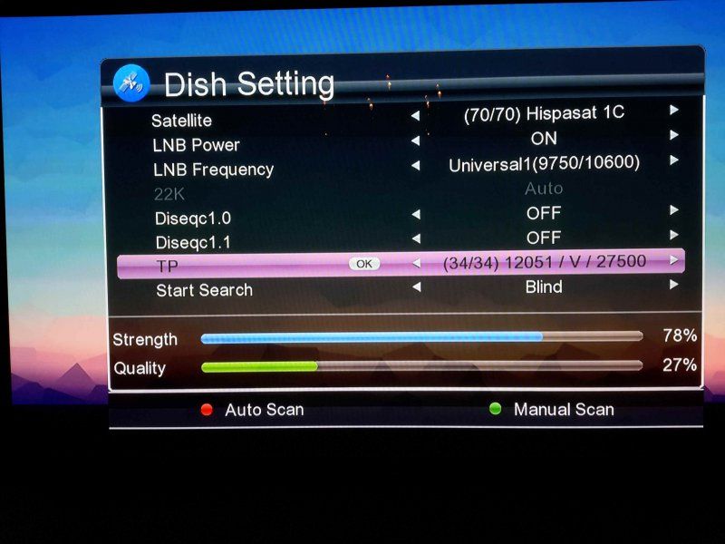

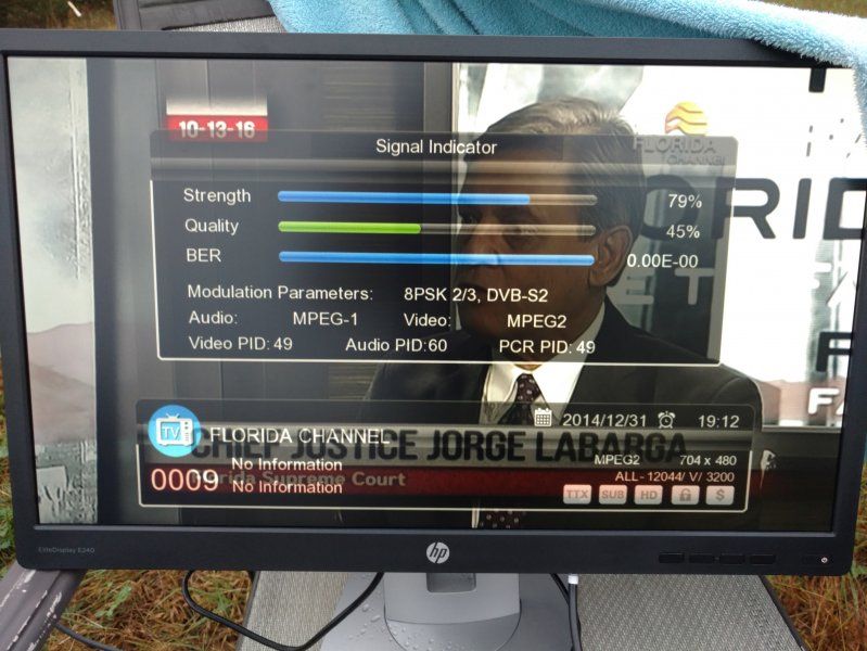

Well got the 90cm installed today (almost) tried aiming it up and scanned what I beleive to be a few channels off SES2 (87W) can anyone confirm if this in infact the bird I have locked? Quality is yet to be tweaked as it was raining a bit too hard for me to sit out there and tweak. I'll jump back on it tomorrow
Reactions: hank123 and FTA4PA
Congratulations!
Yes, The Florida Channel is on 87w. As long as the pole is plumb, the motor bracket is not twisted and the receiver's motor control was set to USALS, the rest of the satellites should be just an automatic USALS motor move away!

Welcome to FTA and congratulations on finding 87W. % signal quality levels, at least in my experience, vary from receiver to receiver. Some are generous and others not so. % signal quality also varies among transponders too. I always adjust for the best % quality while also judging how the picture looks, it should have no pixielation or frame freeze. Bringing out all your equipment (receiver, TV set) to the dish is a perfectly acceptable way of optimizing your reception but of course not the only way.
