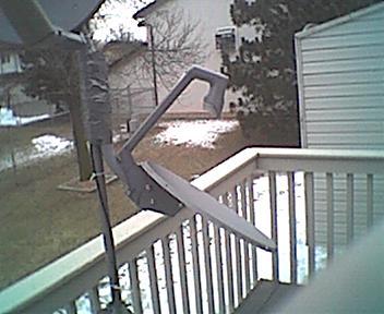

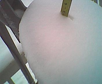

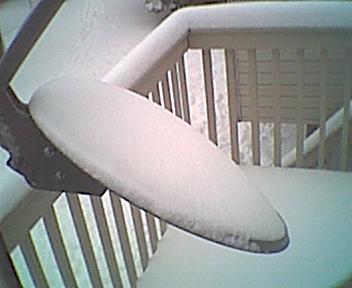

A few years ago I did that with 61.5
I had the dish inverted and when it snowed it did collect on the dish but at the time (this was Feb 05 according to the pics) but it only dropped the signal a little bit with 3 inches of snow on it
