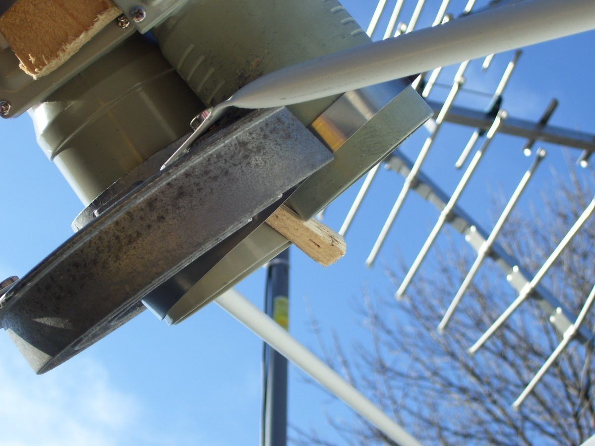

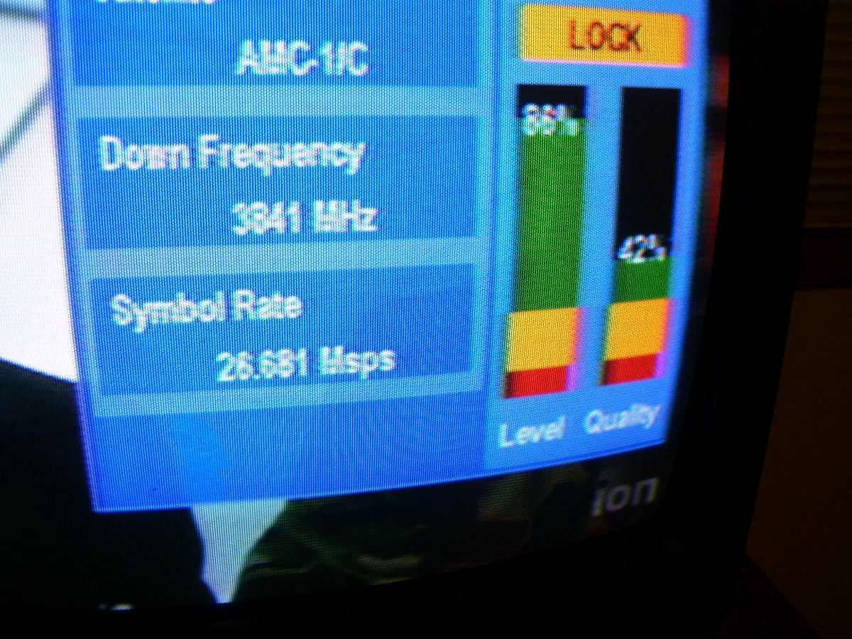

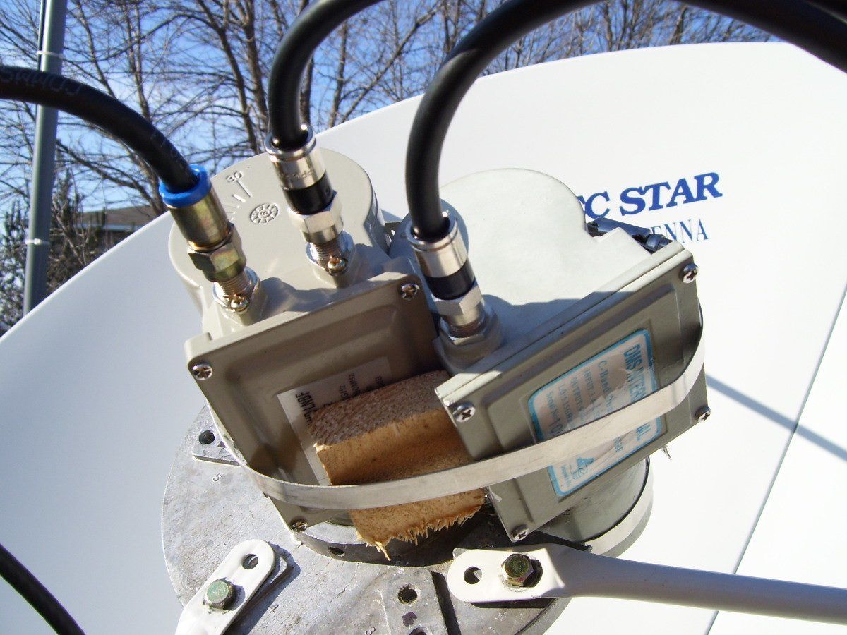

Here's what I mean with the signal.
I use to have a 2nd LNB bolted to my main LNB at 99W and Ion was at 42 quality on the Pansat 1500...This is on the 6 footer

I love the way Iceberg makes things work. He really is a true anything goes hobbyist :D
Nicely done Iceberg, I might give that a try with a 10 footer in the spring. Certainly not on the 6' I have now. I have a tolerable signal now and I was able to watch some of the Ion channels last night at between 24 and 32 quality........it's jumping around quite a bit.
