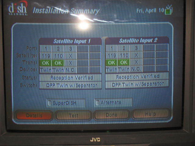

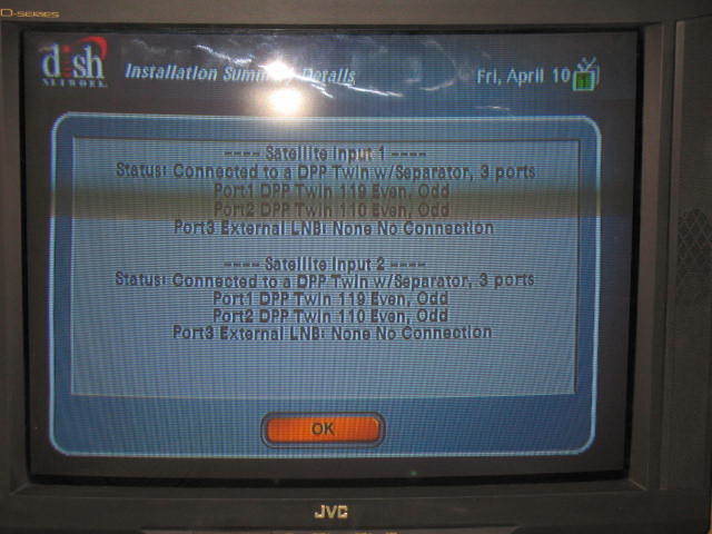

Pics.
--Hi, Pepper. Here are some pictures of what I found out. Also, just looking at the dish, it is at least labeled a Dish 500. Hope this is what you need. Thanks.

Definitely a dish500 with a twin, pointed at 119 and 110. Yet, according to your experience, it was for a few days getting at least one channel from either 61.5 or 129.
