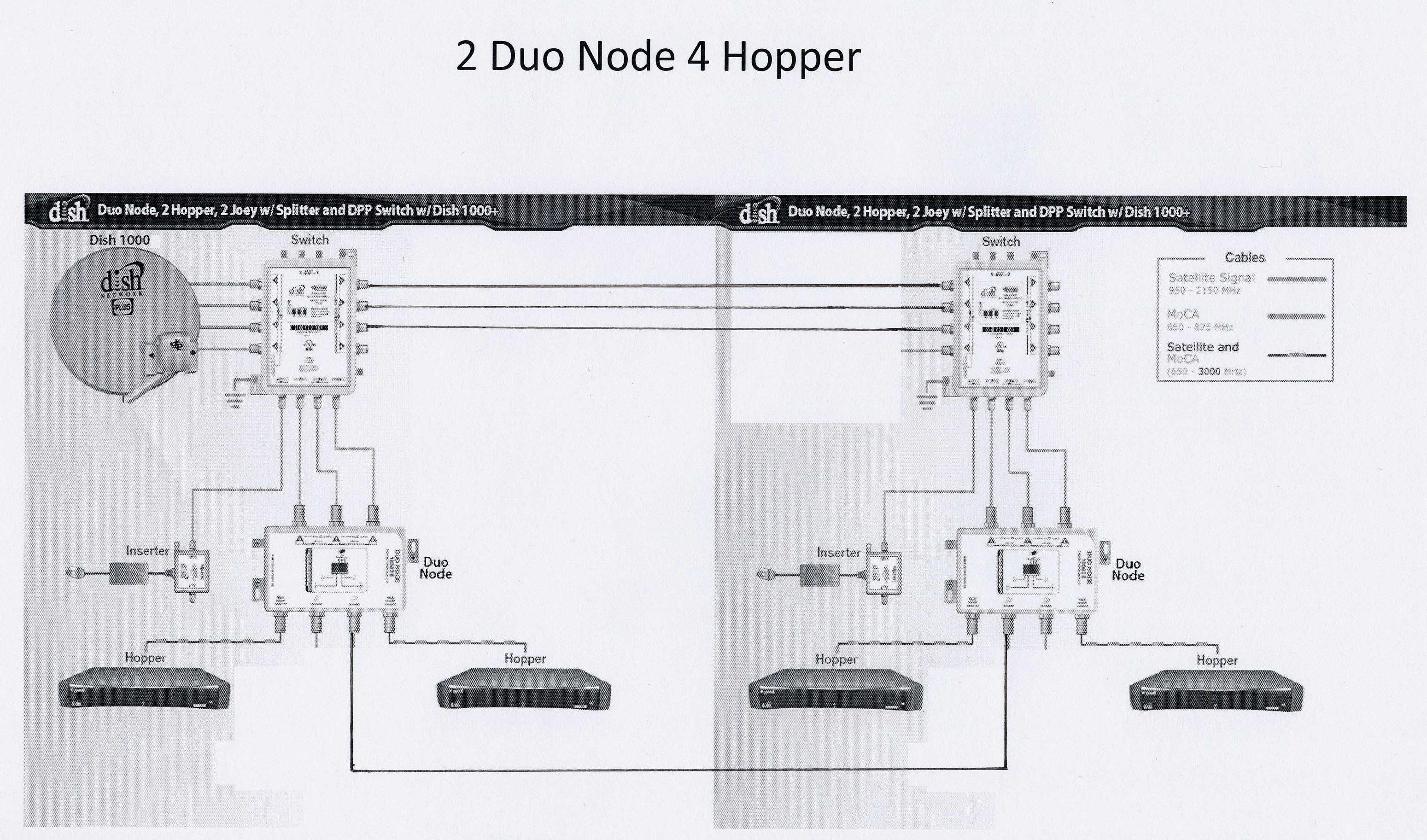

here is a technical question for all installers
is it possible to connect 4 Hoppers and 8 Joey's to a single dish ? using 2 DPP44 switches with power inserter ? I know it works with 2 Hoppers and 4 Joey's on a single dish with the DPP44.
I know there can be only 2 Hoppers on an single account but this is not the question, I like to know about the technical issues.
Any input is highly appreciated !
