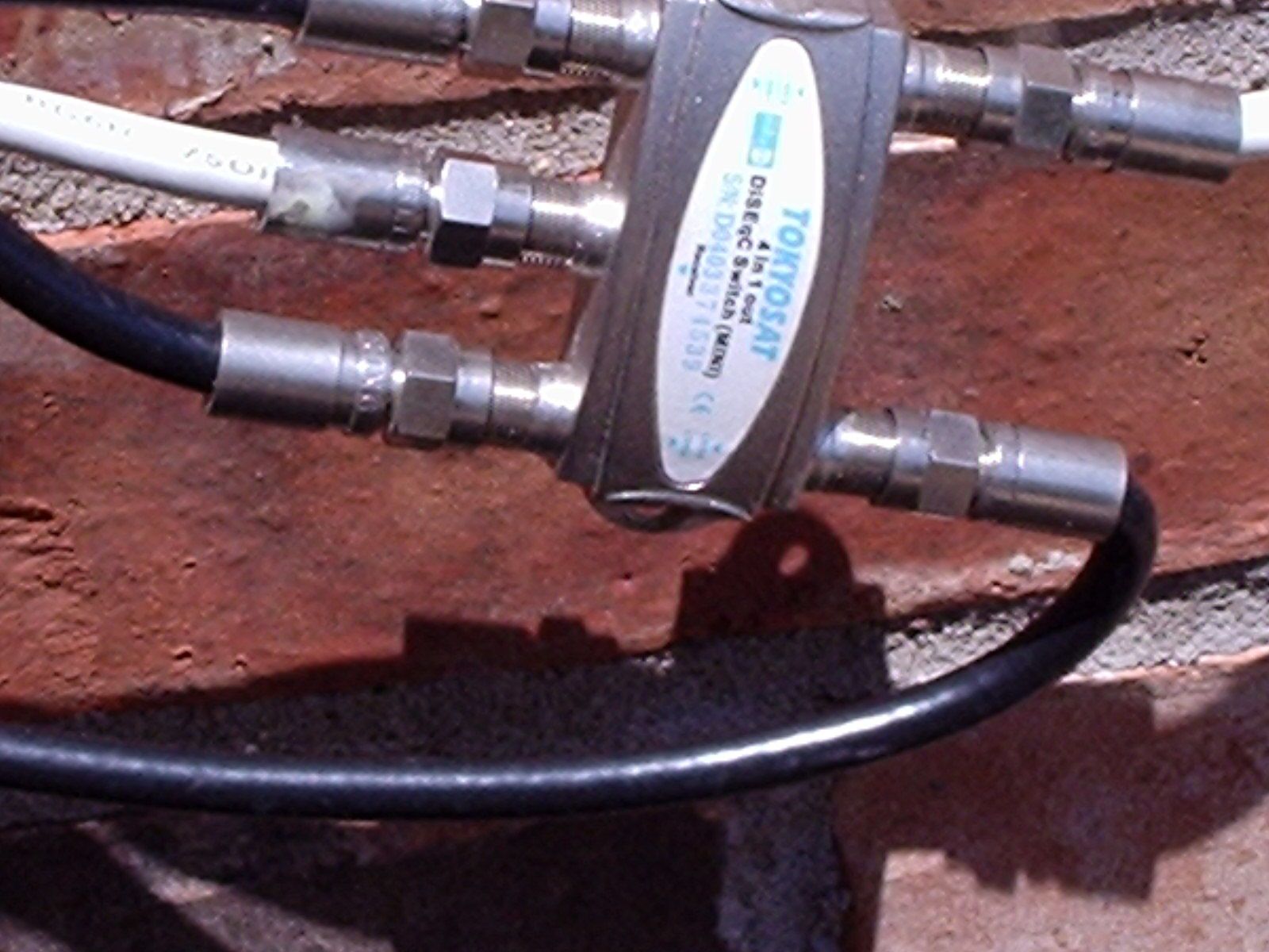

DirecTV and Dish Network don't match, but with DTV, there is a switch 3x4 that may work with your free to air system and DTV system, but unfortunity, its only for one side of the polarity for your FTA system.
But, I knew it is also a switch from Aspen also work with FTA and Dish system, because I saw a hack system that work with FTA.
OOh sorry wrong brand, its Tokyosat switch.
