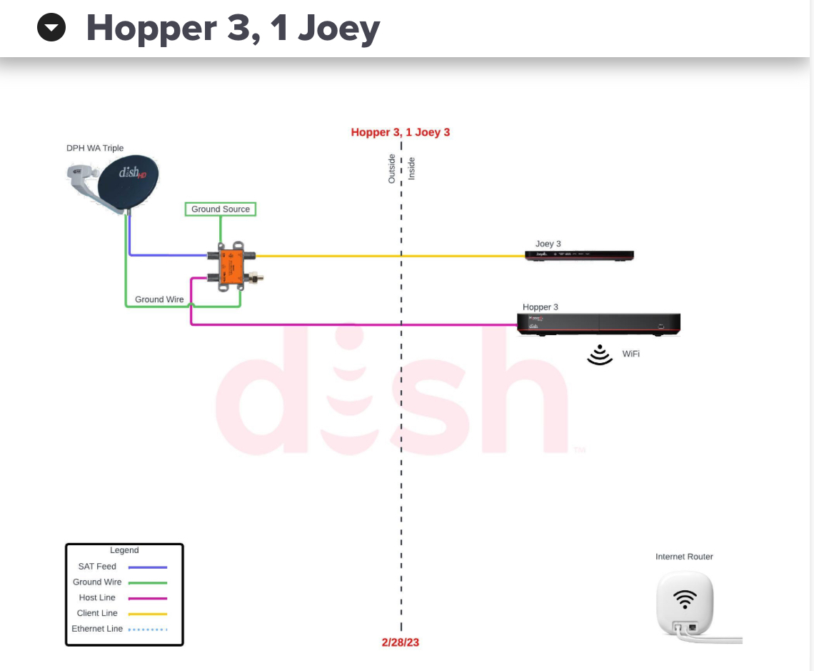

Here you go. Obviously you wouldn't have the joey, but imo if you're doing a hopper3 might as well get a Joey and ditch both 211s. Then you only need one dish with one cable from the dish and both tvs have access to recordings and internet features.
