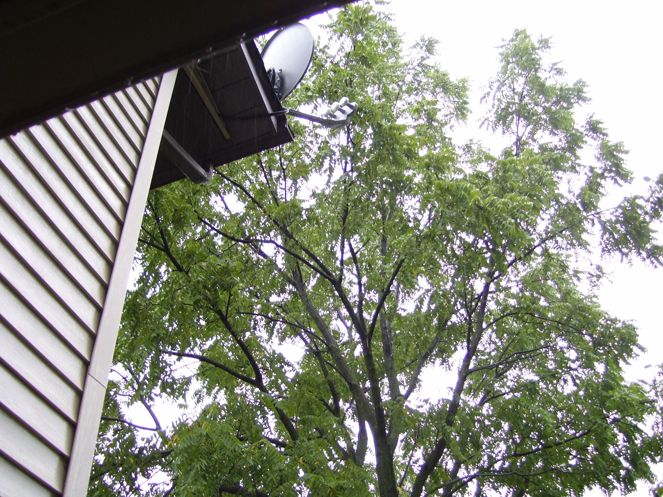

I have a question for all of you Dish subs out there, and particularly the dish techs. About a month ago I had Dish network installed at my home, so obviously conditions at my home couldn't have changed much. During the very first cloudy and slightly rainy day we had quite a few signal losses here. During the very first thunderstorm here, the signal was gone during the entire event. So I checked the signal strength from all of my various transponders on a clear day and found out the following information. I was getting an excellent signal from my dish 500 that was pointed at the 61.5 sat. On my 1000.2 dish, I was getting an average to good signal from the 119 sat (low 50's in the new software). However, I was getting a very poor signal from transponders 7, 11, and 13 on the 110 sat (low 20's), and the same poor signals from transponders 8, 11, 19, 19, 21-23. 27, and 30 on the 129 sat. So today i had a tech come out to repeak the 1000.2 dish. The guy knocks on my door and tells me that he's surprised I have a signal at all. That the gap between trees that my previous tech aimed the dish at was the smallest he's ever seen. He said if he moved the dish, I'd probably lose signal from the 129 sat.
Here's my problem/question. Can he determine all of this without ever even going on my roof and taking readings? The guy never even took his ladder out, let alone went on the roof to check readings. I guess I would have been more inclined to believe him if he had done that. The other thing that seemed odd was he kept saying he'd have to move the physical location of the dish, not make slight directional changes to it in it's current bracket. I don't know, I left having a feeling that this guy just didn't feel like taking the time to "tweak" the dish. What do you guys think? What should I do?

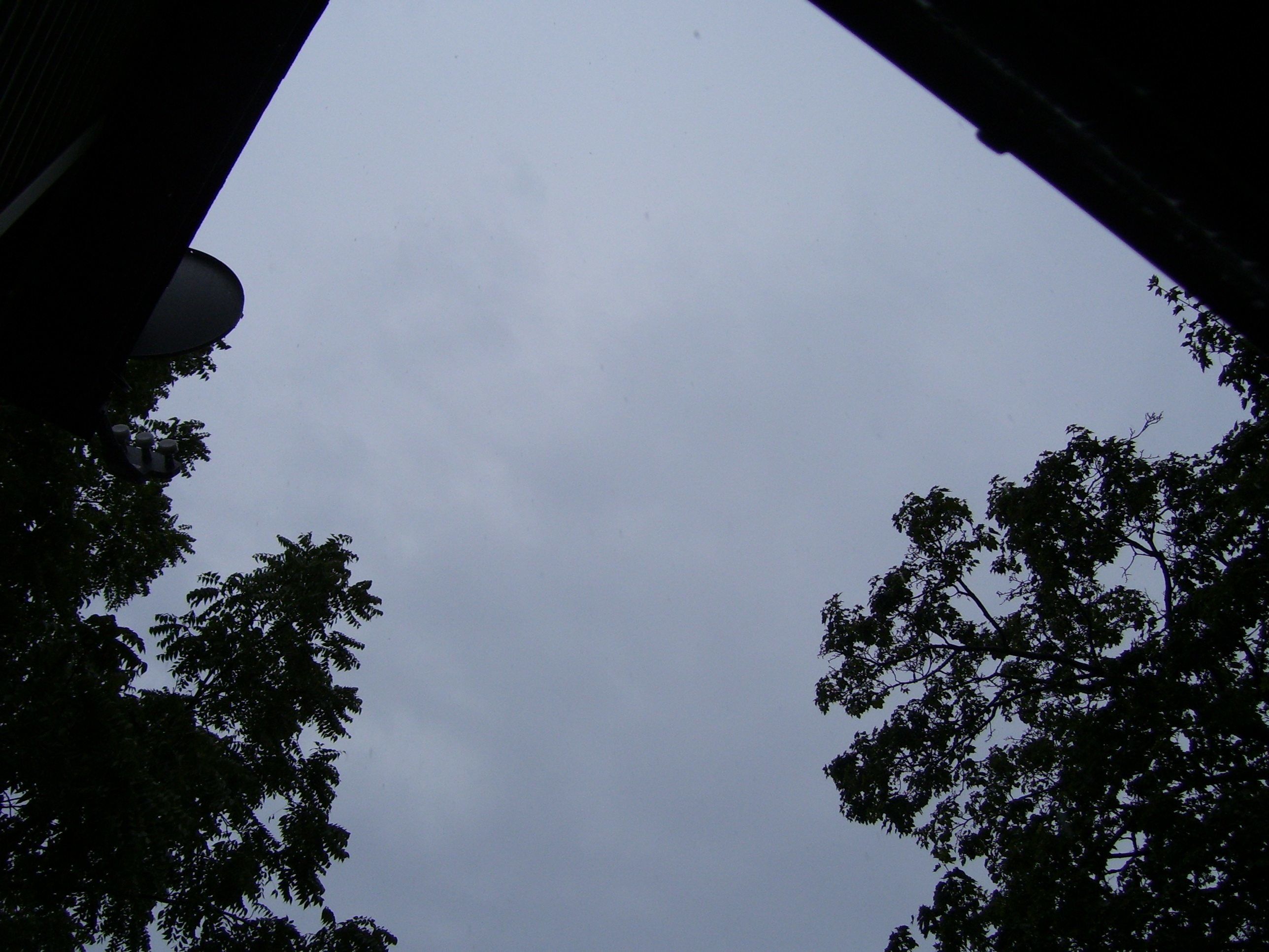

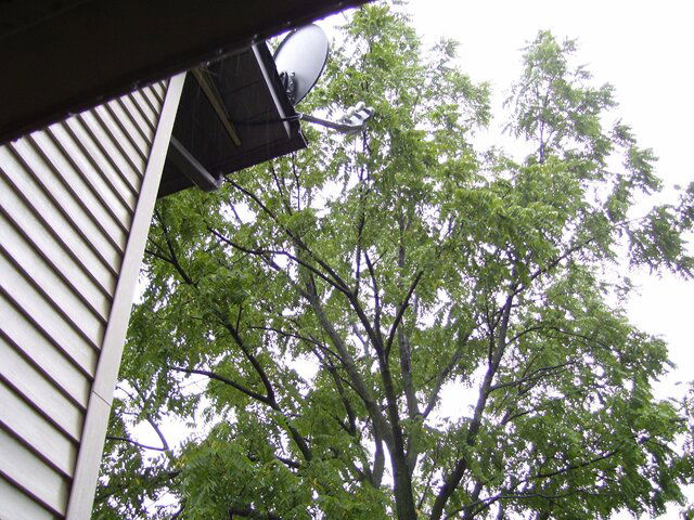

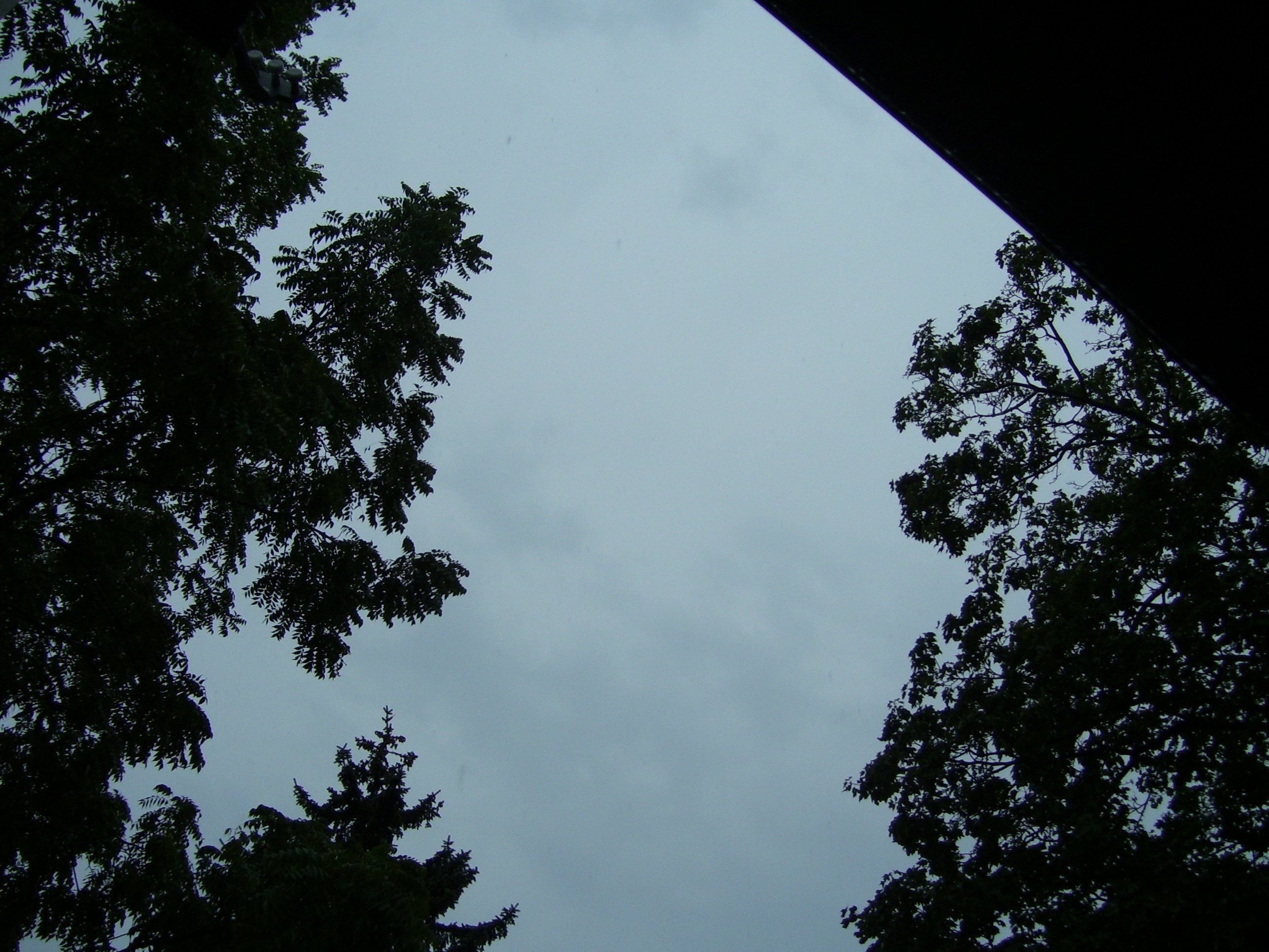

Ok, I think the best thing to do is post some pictures of my setup outside, maybe that will help you guys in determining the facts. I'll post some pictures in a few minutes.
Ok, the first picture simply shows you my dish, and where it's at. The next picture is essentially the lower portion of what the dish would see, followed by a picture that gives you a much better idea of what the dish is seeing (you can see my dish to the left of the picture. Essentially you see a "V" shape with less obstruction as you go further up on the horizon.
You guys be the judge.

Too hard to tell from the pictures given, a picture from behind the dish itself would be more ideal, but I'm not expecting you to go up on your roof to take a pic.
Ye might be better off calling for a second opinion. Not to start a war, but I believe all of Ohio is Digital Dish, meaning your most likely going to get someone that is getting a flat rate of $25 for a service call, your chances of getting a installer that'll basically redo everything is slim to none. Personally I don't blame them, as I wouldnt work 6 hours to make $4.16 an hour to redo someone else's screwup.
My questions are, could it go on a pole at the tree line? Could you go with a Multidish setup to get LOS to the birds, what about a 61.5 wing dish for the HD, and the relocation for a Dish 500.
I don't know if you own/rent, if you live in a condo, etc, basically meaning I don't know what all your options are, and what your willing to live with.
All in all call back, ask for a management to come out and see what can be done.
