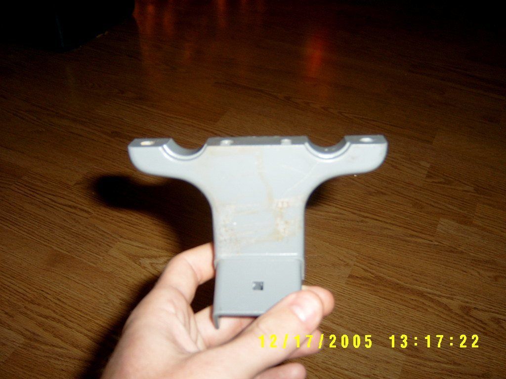

There are all over the place in alabama too. I have a friend that works at Charter that gave me a bunch of them. It was the first time I had ever seen them before. I remember I posted a pic of them on here trying to find out what the spacing was on the two lnbs. I never got a answer. Its for the Charter Anywhere service that was done away with but no one ever knew what satellites they "looked" at. The back of the lnb holder says: Part# 3041215 I know its for the 84E dish with the skew setting on the back.

Here's a pic of the Twin LNB holder

I've looked over the HITS website as for numerous Charter Anywhere document with no mention of what satellites they used. I am mainly looking to find out the degree spacing of the two LNB's. Anyone have any info?
