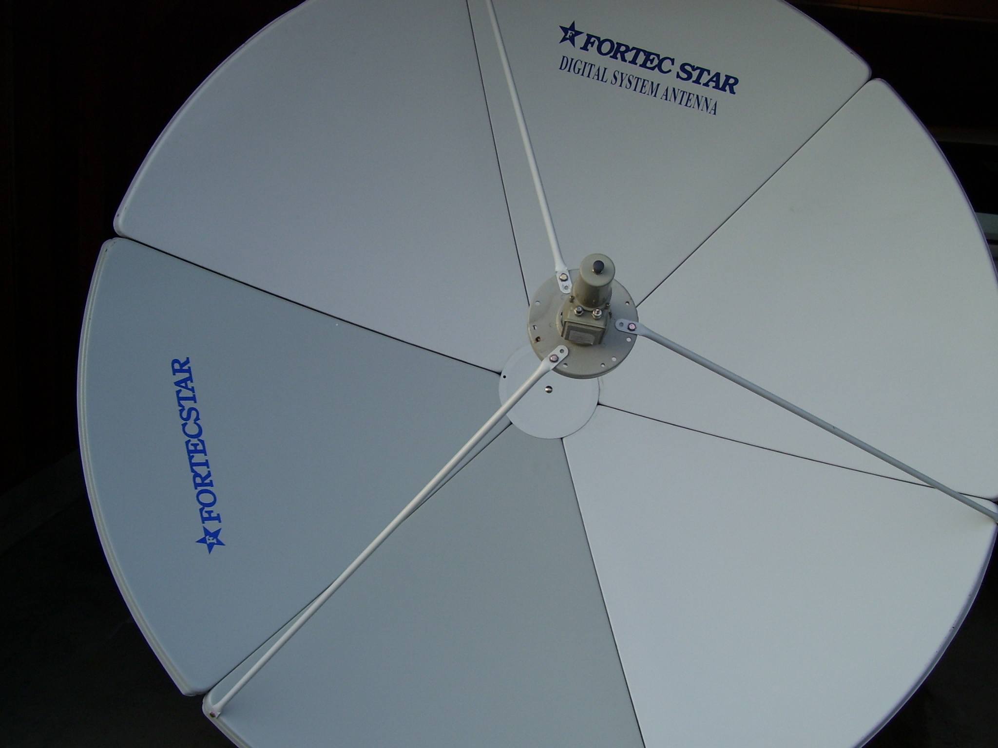

Okay, I'll write up an answer:
1). that photo doesn't show the motor/mount that's offered.
Not that it's a problem. Just took a close look and wanted to clarify.

One thing on the C-Band dishes Scott is they are in pieces so you shouldn't have that issue with something being put on top of it. The pieces all fit within each other so its built really compact
also a lot cheaper to ship
and no yours wont be two colors ;)
