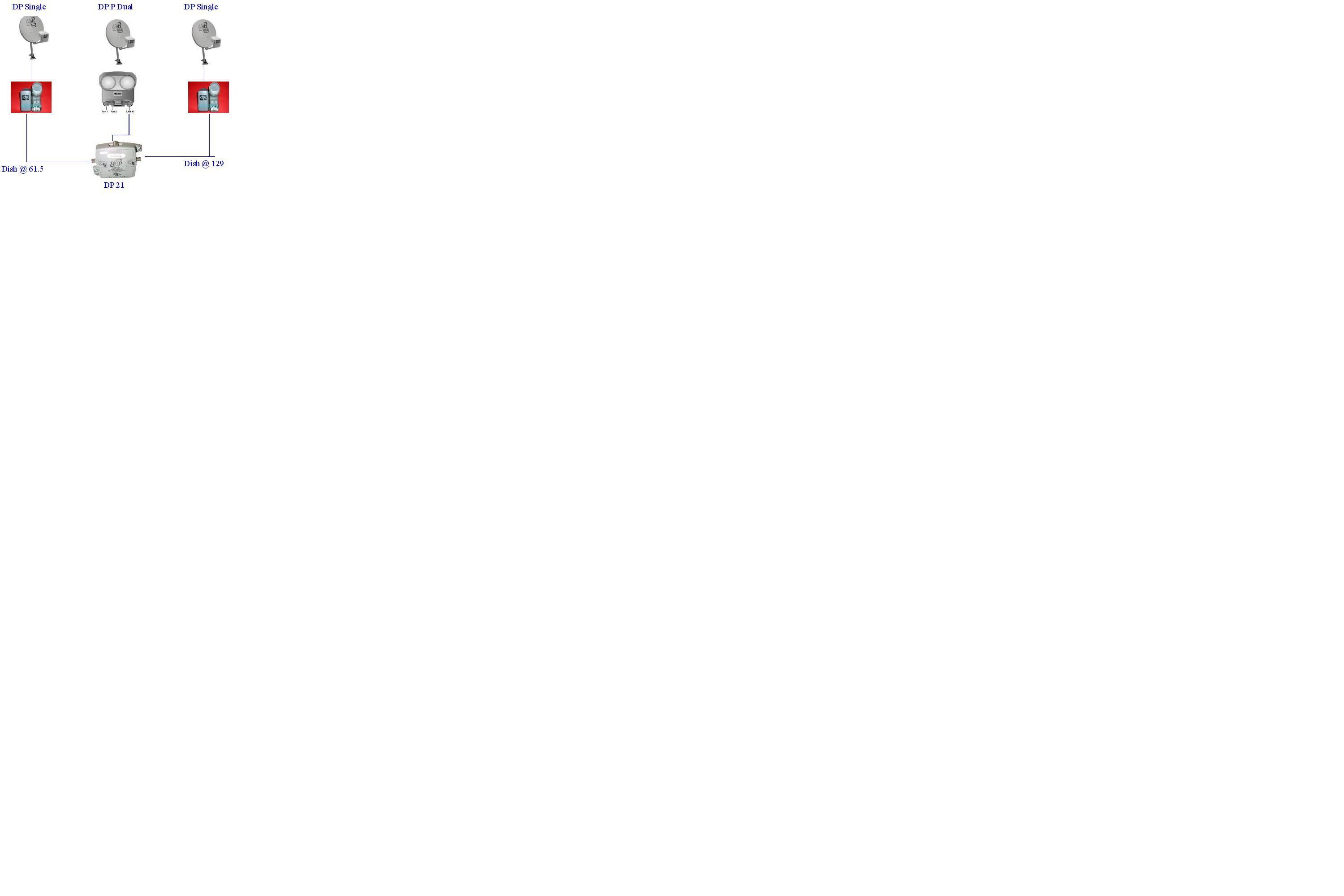

ok I was wondering if you could take to 2 sat. an point then at say 61.5 and at 129 but instead of using a dpp44 switch just use the dpp twin. As long as you use a dp21 switch could that work? SEE PIC if you are confused (srry about small pic just zoom in). Now I know you can hook up 5 sat locations w/ a dp21 and a dpp44 this is where I got the Idea from.

Going by your pic diagram I would say no because you have the 500 going into the out port on the switch, the 61.5 going to port 1 and the 129 going to port 2. To do what your wanting to do you would need 2 sw21 and a little luck but I dont think it would work even then.

I would say no. I would think that the DPP input doesn't have switching capabilities to pick between the 61.5 or the 129 inputs on the DP21. It would be interesting to see what would happen if someone tried it.

Simon is right, it will not work with the DP21 and the DPP Twin. This is from the
TECHNICAL INFORMATION BULLETIN
Subject: DISH Pro Plus Twin LNBF Installation Information & Special Considerations
"The DP Plus Twin may be connected to a DP Plus 44 switch, but not to DP21 switches or DP34 switches."
