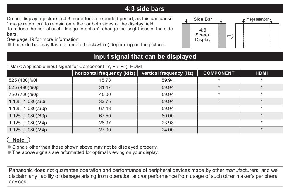

From the manual for the 55" ST30 model. (Other sizes should be the same)
Supports 480i, 480p, 720p, 1080i and 1080p. Refresh rates supported are:
Screenshot from 2019-03-14 14:54:45.jpg
Hope this helps! :)
