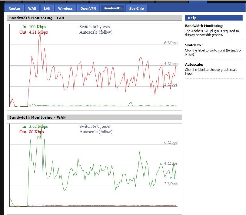

what was the quality setting set to?
and do you have a bandwidth monitor within the pages of your Gateway Devices' configuration pages?
Its one of the first ways I found that *certain assertions* of *certain people* ;) were not correct about how the SlingAdapter in-home worked..
On PC's & Mac's there are log and configuration files... and inside those you can find evidence that proves the streams *can* be handled in different ways.. it was one user (not sure if here or on DishSupport) that also monitored their connections (even more so than i) and he found his Iphone and Ipad stream did in fact leave his network and come back in.. but others have posted they don't see those conditions ..
so.. best way to know is having the ability to watch traffic .. in my case that's DD-WRT running on my gateway router ... I also run it on my bridges, and love watching the traffic at X megs from one point to another to out the gateway or what not... I know... kinda geeky :)

the laptop though should be going directly between the laptop and the receiver .. only the administrivia then, goes outside the network to Dish/Sling .. things like authorization, optimizations, commands (pause/play/channel/etc) ...
The only way to know for sure if its leaving your network to relay back to the phone, would be to monitor bandwidth and look for traffic patterns, or logging directly on the netgear to show that a the data is going out and back in..
On the status page of the router's web interface, there may be a "statistics" option.. that might be able to show you the amount of traffic in/out/wireless/lan ..etc.. and with nothing else in use ... if you see about as much wan activity as you do wifi / lan activity ... that would suggest it may be a relay too..

If you have a spare router that can run DD-WRT you could get a lot of information ... or if you had a HUB that you could use (yes a Hub not a switch unless it supports a monitor mode) You'd watch for the traffic to see where its going .. that way you'd know..
