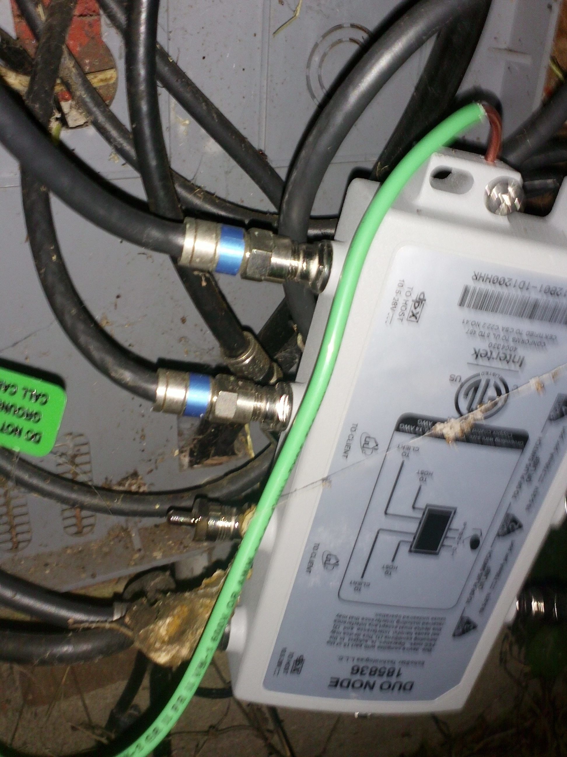

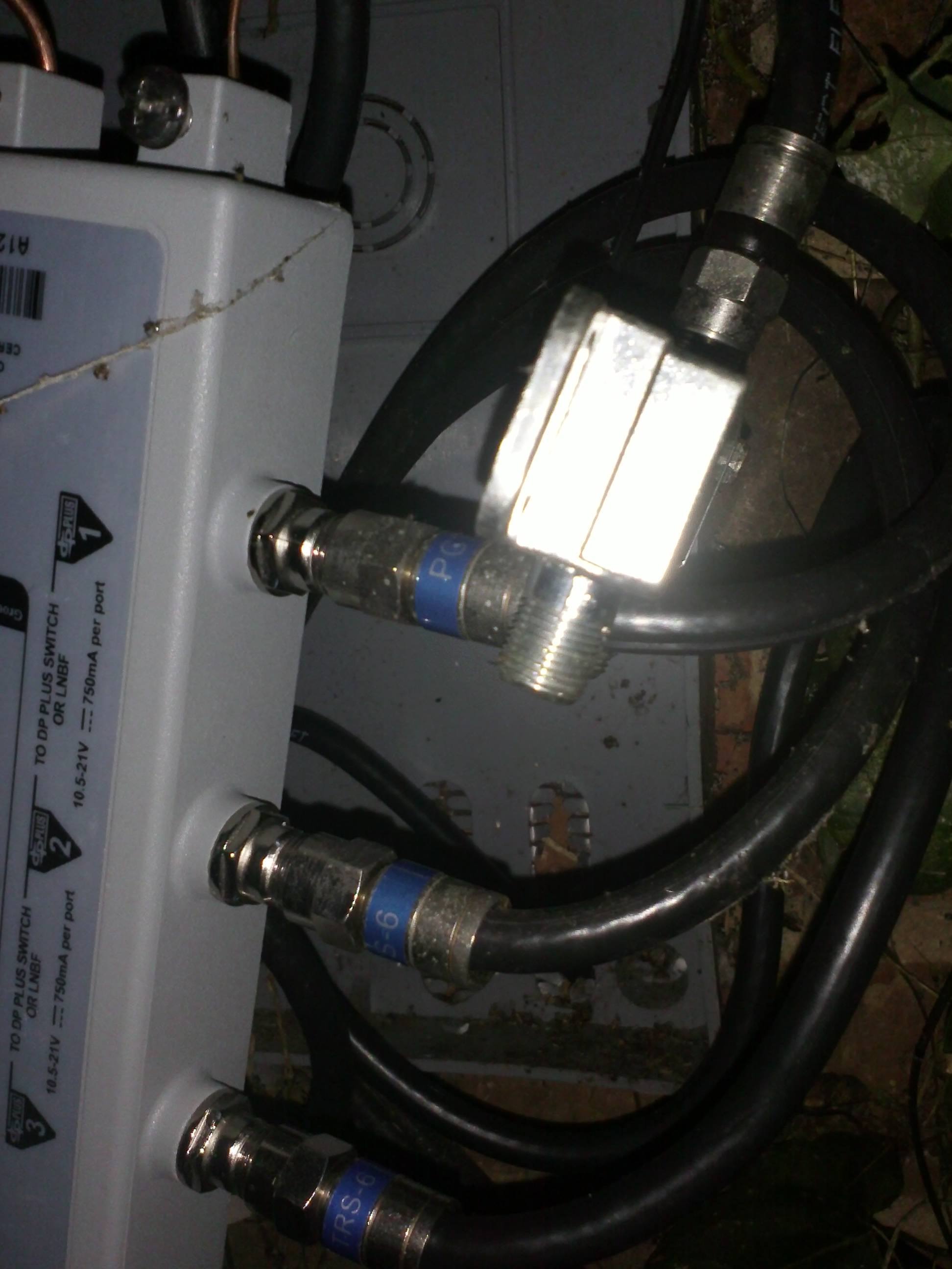

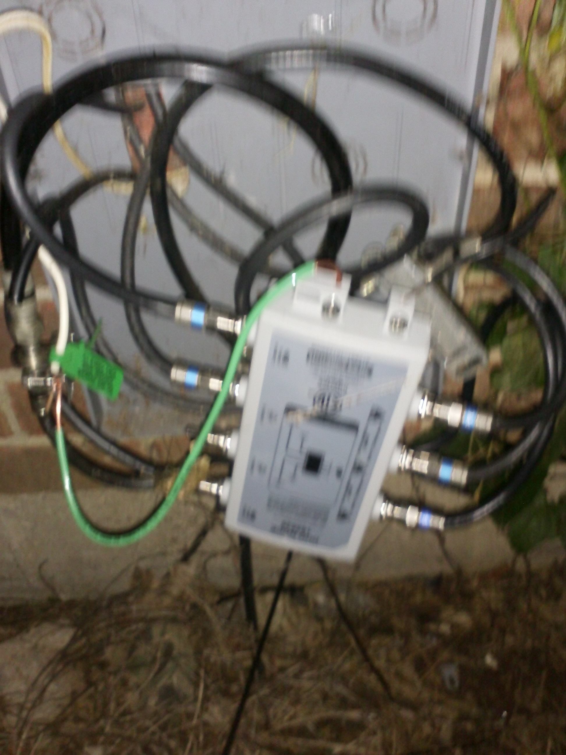

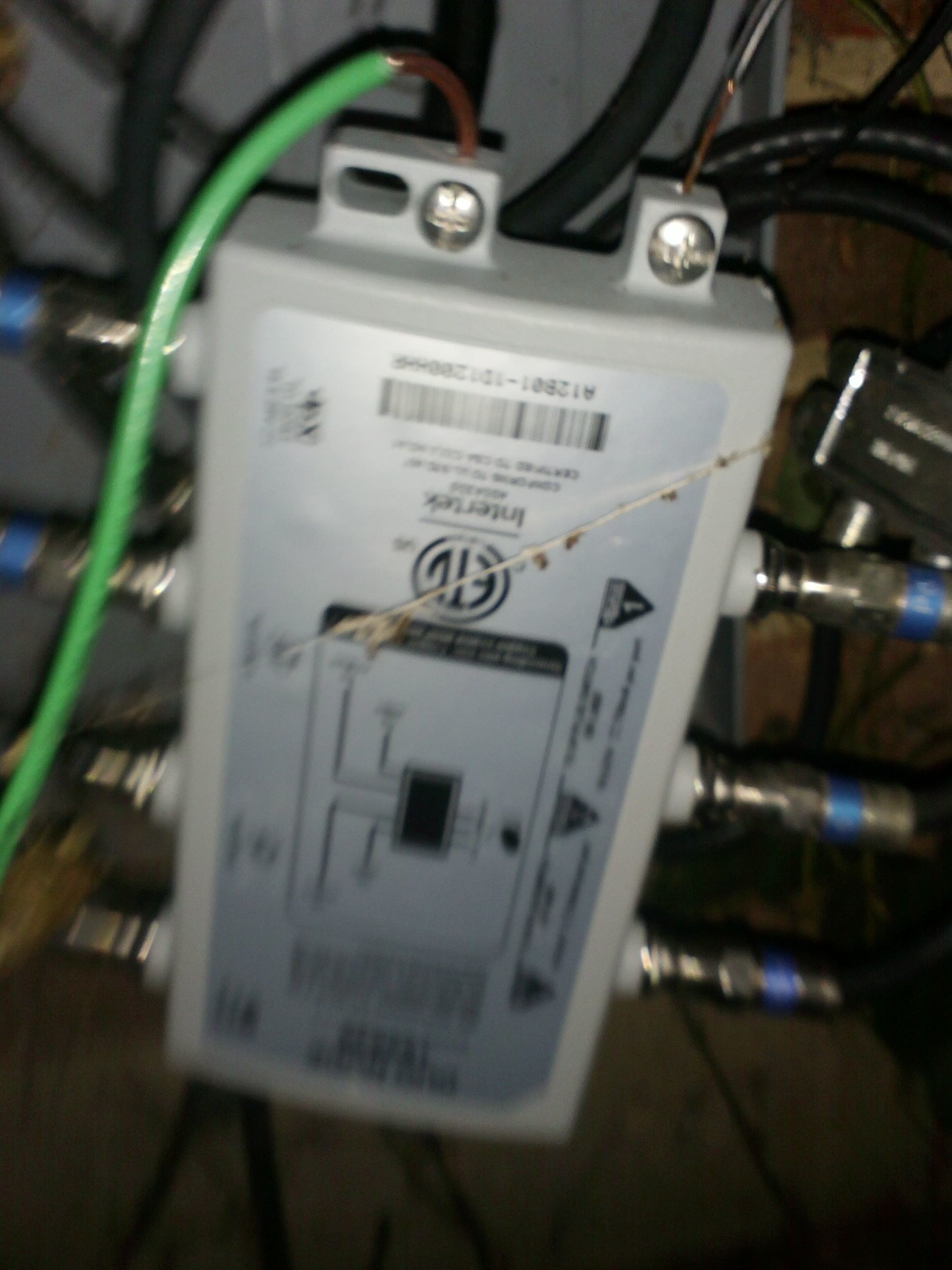

Cable is RG6, should I try to use RG11? I believe the dish is the turbohd 100.2 eastern arc. Nothing extra, just the duo node. There is an unused splitter in the box as well. I asked for a supervisor, and when he came out, he added a HIC, then said everything looked good and left. They are supposed to be here between 12 and 5 today (Sunday) to "fix" it. I have one hopper box from dish on its way, should be here Tuesday. With these issues happening in more than one box, I might just replace the hoppers with a few 722k's.

are the hoppers connected to the host ports of the duo node? 1 hopper per host port. hard to tell from the pictures as i can't see anything on that second host port.
The only thing that should be on the client port is the HIC since you have no joeys.

It LOOKS like there is a fitting behind that gob of brown stuff in front of the bottom host port for the 2nd hopper. I'm assuming the hic is connected off the client port and not off a tap somewhere else in the sytem. Either way that's a sloppy mess of cable at the node. You may just have a bad hopper. Keep us updated.
