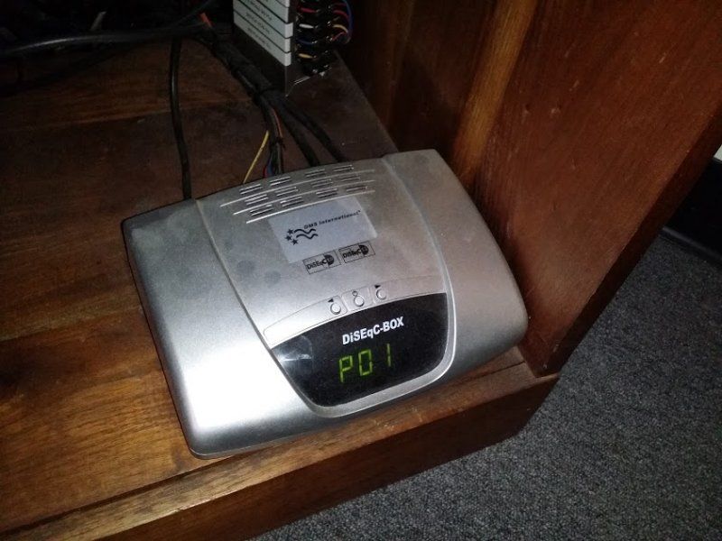

So, "the morning after".....signals were dark, but a clue emerges, perhaps. All the great progress seemed lost. Black "no signal" screens on the fixed-position satellites. THEN....I told the system to move the Birdview to another satellite. After the move, ALL the signals programmed in last night work. Until it sits awhile again. It's almost like the positioner is stopping the diseqc signal from getting where it needs to be unless you wake up the box, make one move, then even the fixed ones work. Seems odd, but it seems the only variable, too. Is this possible? Any input appreciated. Yes, I need the new Titanium box...which should swap in fairly well with a little help. Being at this AM station, our sensor doesn't run on 5 volts, it runs via a rotary encoder at a higher voltage provided by an external interface box.
The BIG question to me is, can a positioner block disecq signals for any reason until after it's activated once? Maybe the feed-through really isn't so straight and goes through some circuitry? It's a cheap box.
I'm also beginning to wonder if there's some general T-I in my area that is more prevalent in the daytime...
Today it's bypass the positioner day, leaving all dishes fixed on their settings to see if that stops the problem from occuring. If yes, we have a connection issue through the box. If not, it's maybe some damaged cabling, T-I, or something I have no idea how to find.
I'm sure my new satellite meter/device will come in handy with this problem..but input from others will help even more.
Don't tease me about the dust on the box, please. Maid's year off.
DiSEqC switches should hold the last command for port selection until power is removed or a new string is received. The DiSEqC switch doesn't need signal at all times to stay in the selected position like a 22KHz switch requires to activate the 22K-ON port.
With your location RFI issues, it wouldn't surprise me if the switch doesn't operate as designed. Maybe try another switch, brand or model? Ground the switch to a bonded ground.
Worst case scenario, install a remote manually controlled coax switch.
Does your positioner re-create the diseqc commands? I see the online literature read as if it could pass through or re-create internally from the commands it gets from the receiver.
