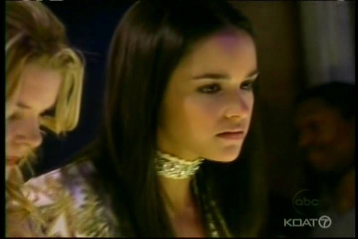

Here is a comparison between C-Band and my E* local... not sure if it will come out but... Big Files Pick which one you think came from the local... added 2 more jpegs, you can still see...

Errrr...no comparison
No Question here...475 looks like the winner to me!:D

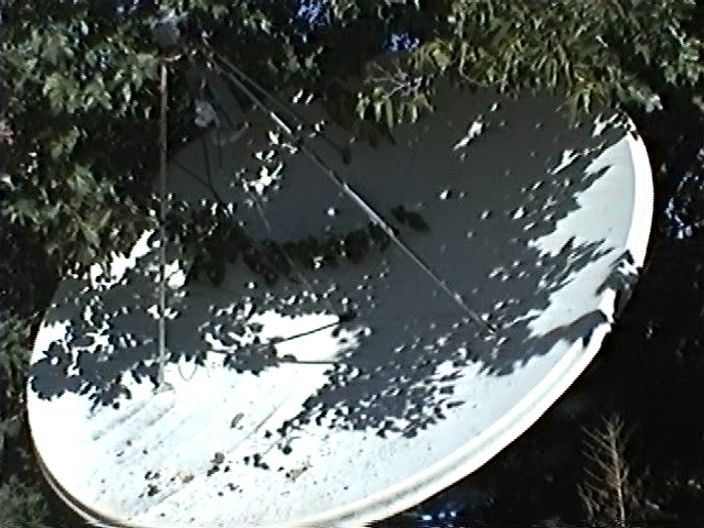

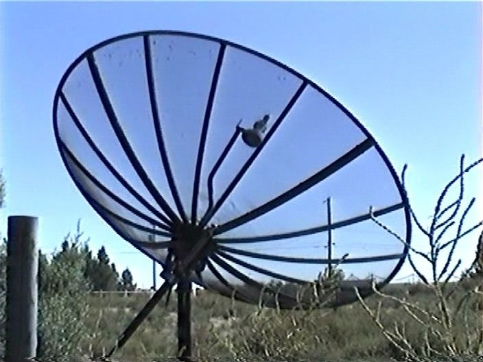

dfergie said:
My BUDS, taken in Nov of 04...
Now I see what you mean....Never saw a BUD UNDER a tree before. NICE DISHES THOUGH.
Hey, there is always the ROUNDUP treatment:D
