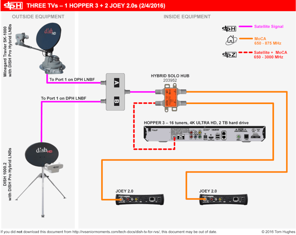

I don't have an OTA adapter connected to my Hopper 3 But I did find some information about the interconnect on another site.
The MoCA signal is 650 - 875 MHz from the hub to the client. The signal to the Hopper 3 from the hub is 650 - 3000 MHz.
I won't testify to the accuracy of the document I found but here is the wiring diagram from the document:

I can't answer why the OTA signal is worse on the Joeys. Like you said the Hopper 3 has to process the OTA signal first the send it to the Joeys.
This could cause the multipath to be "amplified" when viewed on the Joey's. There is another thread here about the OTA adapters have pixelation
problems so installing a better antenna, better coax on the antenna or an amplifier may not help. Good luck finding your multipath problem.
