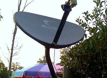

Register to hide this ad
Nice dish! Does it skew (tilt)? On my DirecPC dish there are 4 bolts on the back of the dish loosen them then rotate the whole dish lining it up with the satellite in the sky. (skew)

Is that RG6 cable that you are using? If not it needs to be. looks mighty thin! maybe the light :)

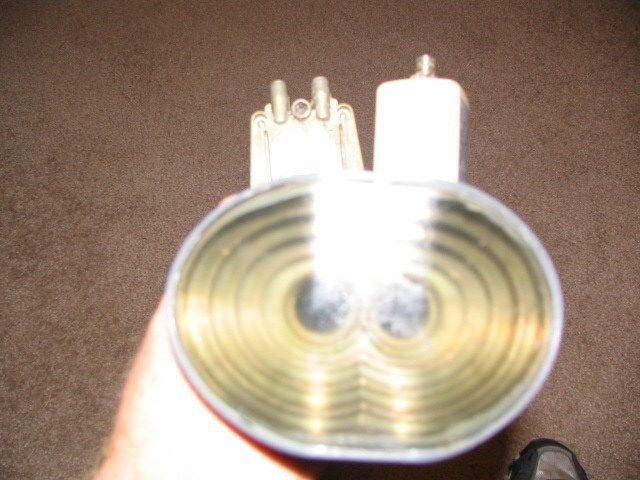

My dish is a Duo, it has the dual output dss lnb and the single ku
OK! I have still have two DirecDuo combo LNB's here with 2º spacing. I used to point them to 101º and 99ºw in this area!

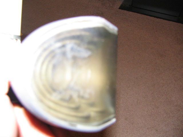

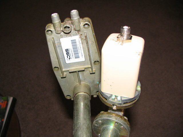

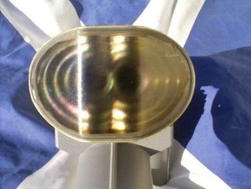

Is this the same? I took this one apart just to make sure no spider webs or other obstructions were inside, It was clean.

Looks like the exact same combo LNB! If the LNB is bad its easy enough to just get a new low noise LNB and bolt it right onto the C120 flange. Its always a good idea to keep the feed horn as it matches the shape of the dish reflector!

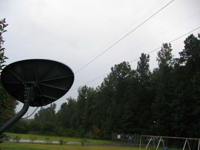

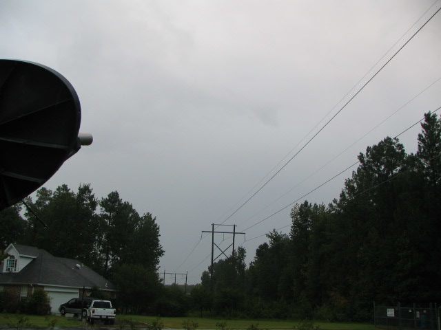

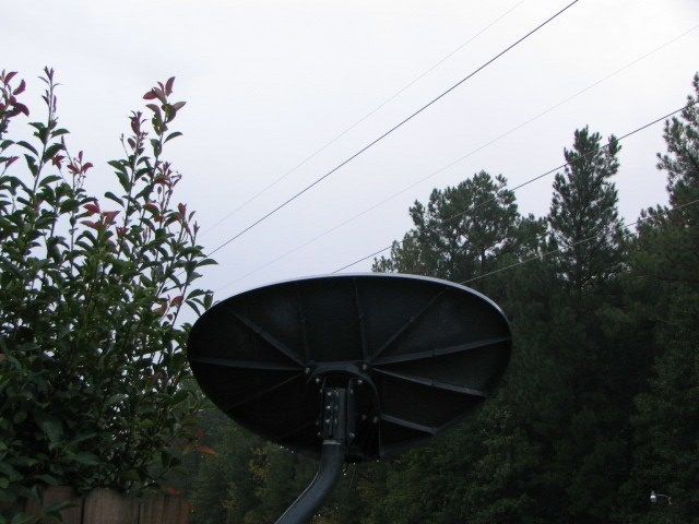

Here are a few pics of the dish pointed, not sure if you can tell anything from them. I've located a Primstar dish to try, hope to get it in the next week or so.

A satellite signal is like a flashlight beam, ANYTHING blocking or partially blocking will reduce your signal quality. You would have to be real unlucky for the power lines to be affecting your signals, not to mention all the satellite are at different heights in the sky (See below)
I also do not see the trees being an issue!
