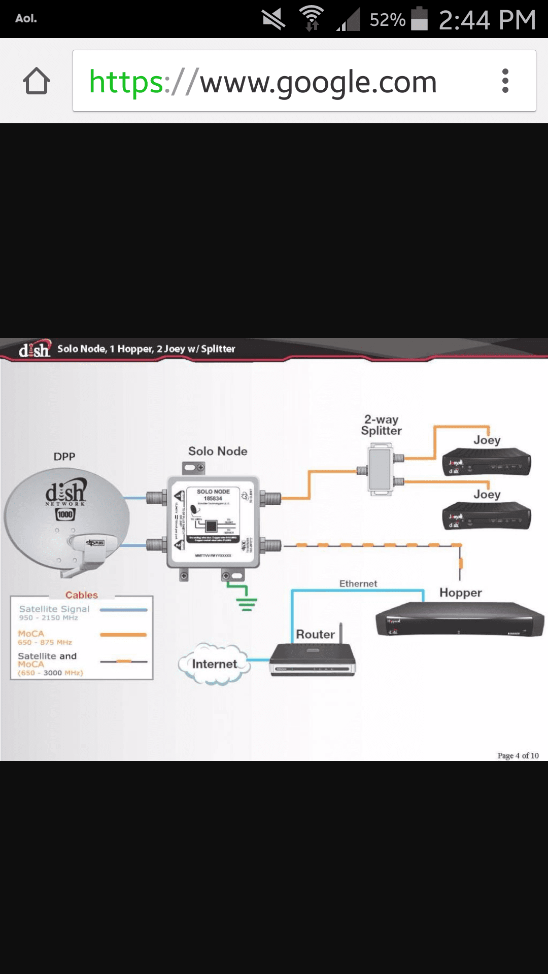

I have a Hopper and one Joey. My internet service is cable. My question is, is the MoCA that Dish uses compatible with standard MoCA that I'd use with the cable company? I know that DirecTV "DECA" is just MoCA, but on incompatible frequencies. I've included a diagram on this post to demonstrate what I want to accomplish, but essentially my wifi is not reliable at my TV location, and I want to use my old MoCA bridge to get internet on the coax network at my modem. I also want to bridge from the Hopper into a switch in my entertainment center so that all of my other stuff like Xbox and Apple TV can utilize the wired MoCA connection.
So, what I'd like to do is connect the Joey connection off my Solo Node into the splitter coming off my cable line, to bridge the two MoCA networks. Will that work? And do I need a diplexer? Or does the Solo Node completely isolate all non-MoCA frequencies from crossing over to the satellite side?

Right, I understand how it's "supposed" to be done (it's installed as it's supposed to be right now), I'm just curious if what I'm trying to accomplish will work, unsupported as it might be. The biggest question I have is what is the isolation of the joey side and the hopper side of the solo node.
It's possible it might work if the cable modem is on a different frequency than the hopper moca. The only problem I see is that there is no way to keep from feeding moca down the cable pipe.

The answer is no, it won't work.
Doesn't look like the cable modem signal interferes with the satellite signal (meaning the Joey side and the Hopper side are 100% isolated outside of MoCA), but it looks like Dish's MoCA uses a different frequency range from the Actiontec bridges I use. The Joey and Hopper also lost connectivity, so that makes me think it's possible the MoCA band they use is incompatible with a cable modem.
If your goal is to distribute internet with the Joey MoCA then you should get a Hopper Internet Connection adapter, otherwise known as a HIC.

I finally found a source that had the frequency ranges for everything. Satellite signals are up in the 950 to 3Ghz range, Dish MoCA is in the 650-875 Mhz range, and my Actiontec "cable compatible" MoCA bridge uses 1125 to 1525 Mhz. So, I definitely will need the Dish bridge (HIC). The problem I have, though, is that I only have one coax run at my modem/router, so I need to figure out a way to get the signal from the cable company over there as well. The hitch there is that the highest frequency my cable modem is currently using is 627 Mhz.
I found a filter that will essentially block out any frequencies higher than 650-ish Mhz or so (because my cable system likely is 750-900 Mhz in total bandwidth, and I also don't need to backfeed the Dish MoCA out to the cable company). Plus, I can't guarantee that the modem channel(s) won't move around.
