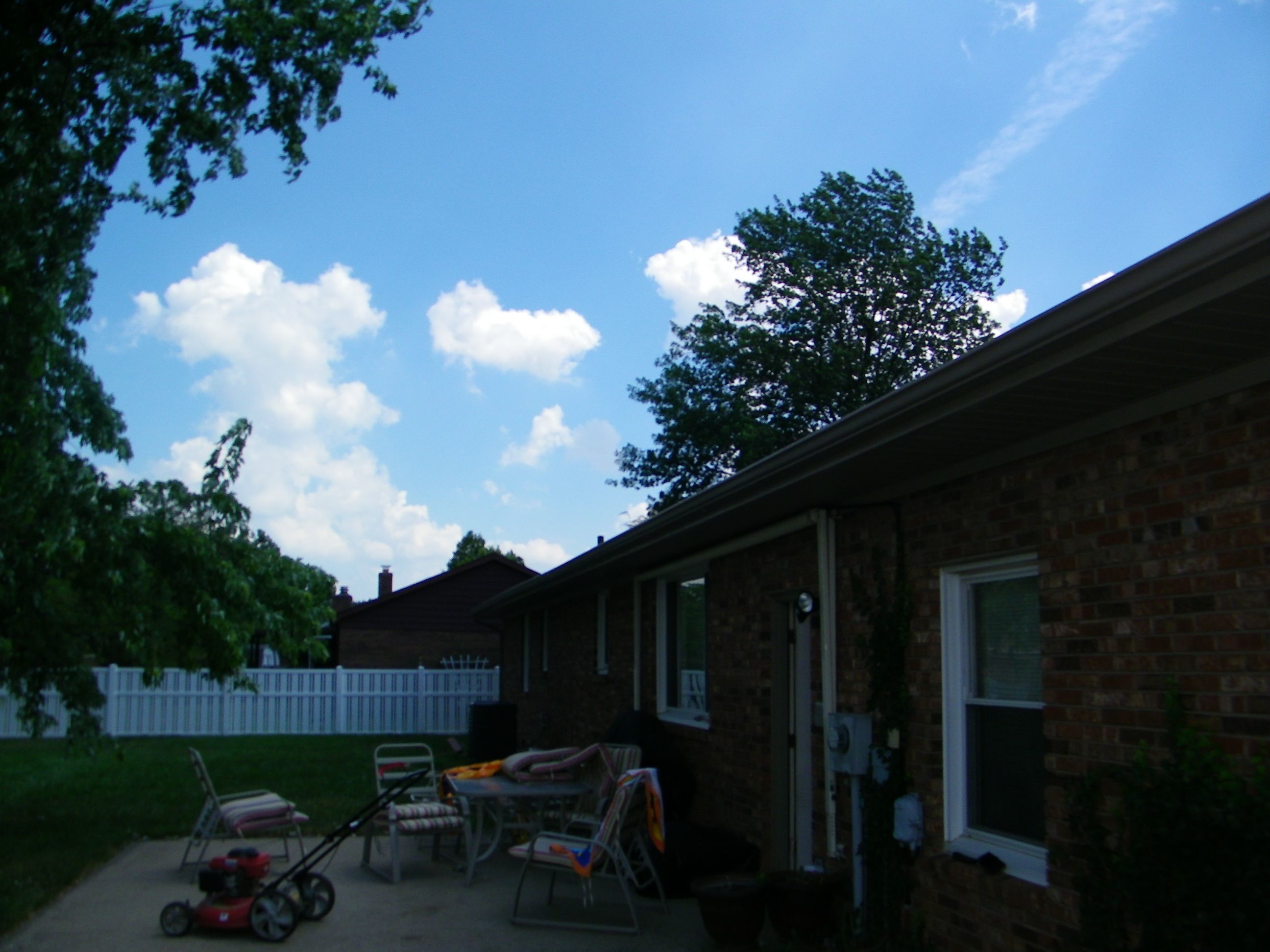

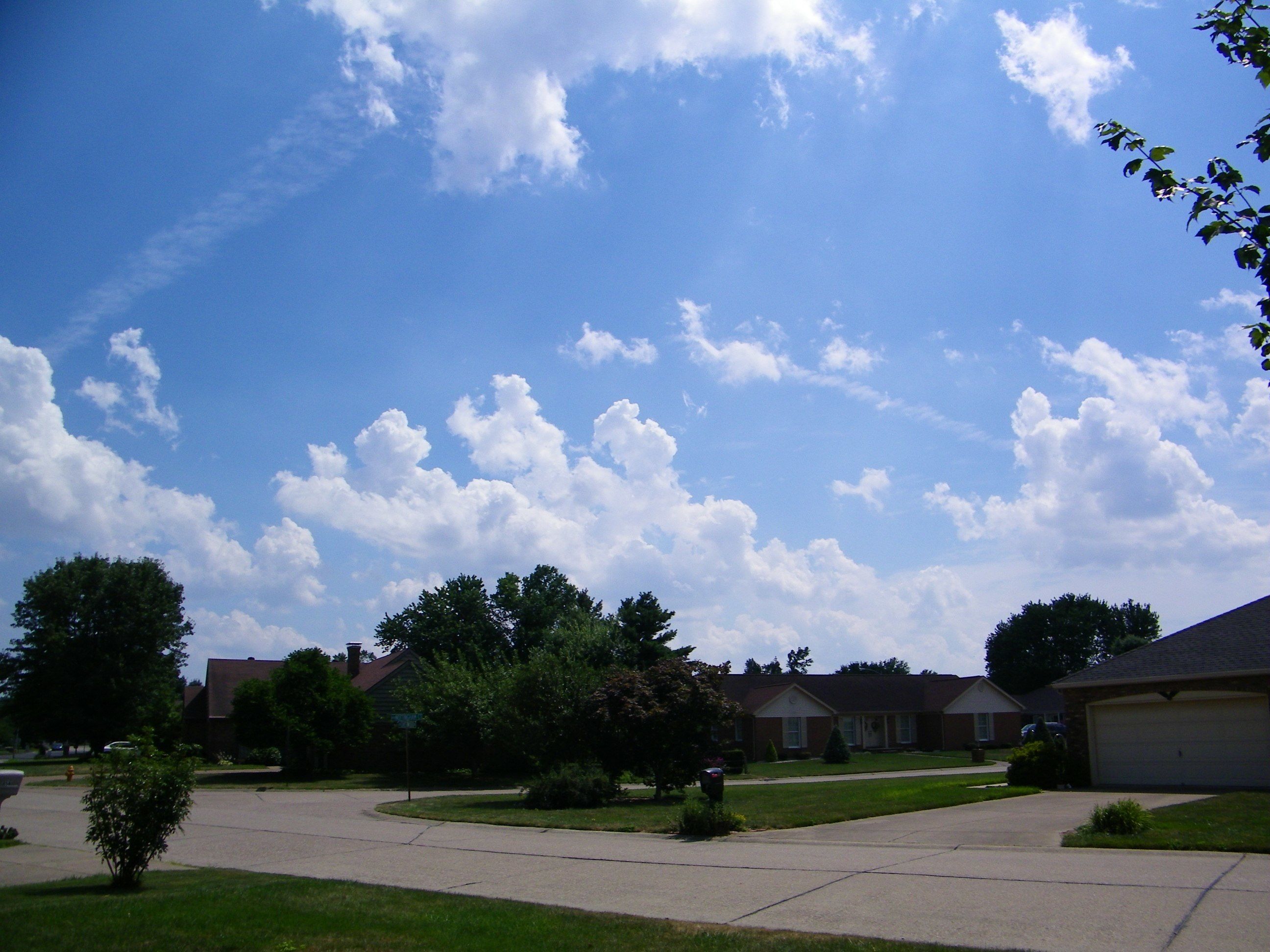

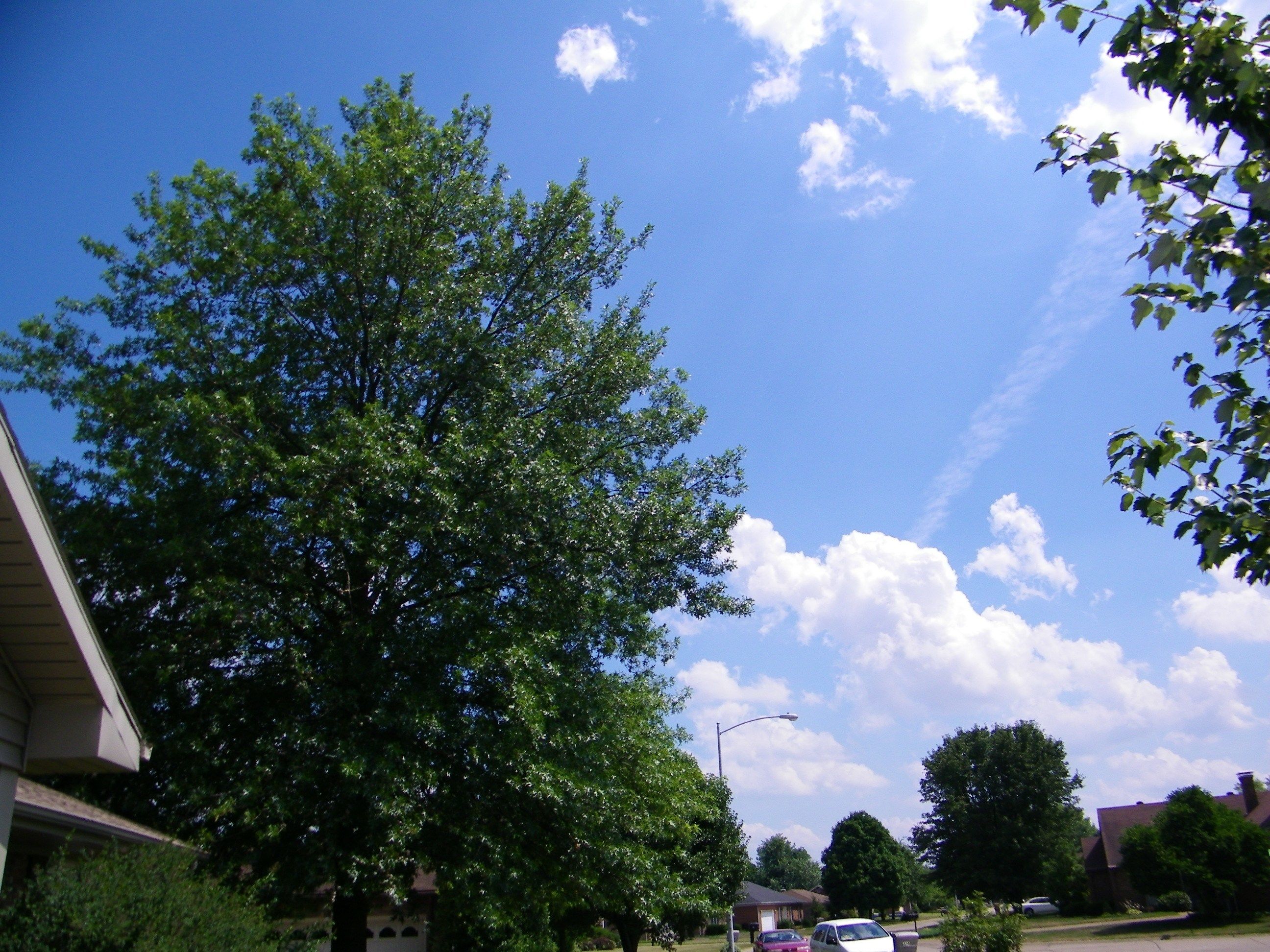

I have attached three pictures to give you a better idea of what I am talking about. I hope they show up.
In the first picture you can see the tree in question in the right side of the frame. Behind that tree is due south. To the left of the tree you start to see to the southeast.
In the second picture you see the same tree from my front yard and get a pretty good idea of just how big it is.
Picture number three shows the wide open southwestern part of the sky from my house.
It's just that one tree I think i'll have to be worried about. But more opinions are welcome.
Thanks again.

So due south is 180° (or there about not accounting for magnetic declination if I remember correctly) - Sounds like you will be fine. What is your zip code? With that you can get an aiming coordinate for a SlimLine dish. This should at least give you a ball park idea. Which may be somewhere around the 200° heading .

I was real close with the guess: You will be fine.

I don't think you'll have any problem at all.
The Sat signal comes in much higher than the LNB arm, therefore I think you will have an issue at all.
Your setting of 201 is more to the SW than S and seeing your saying that the tree is S, your good !
Relax and welcome to the site !
YOU'LL BE OK
I think you'll be ok, I've seen some installs where I've asked how are they getting a signal with that many obstructions infront of the dish. I believe you will be ok with the install, and don't think your line of sight will be an issue.
