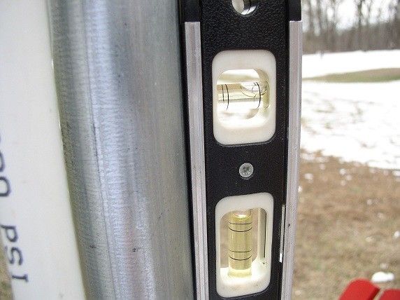

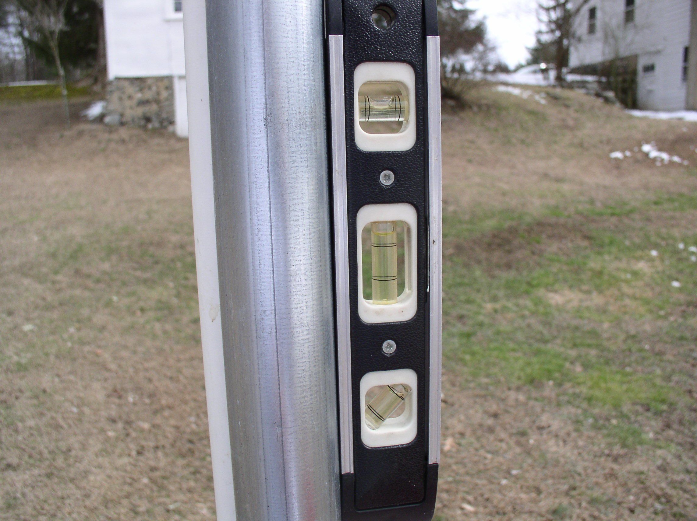

Thanks to all who are replying. Tony. The Post is driven down about 2.5 feet. Looks like 2"emt. might be 2.5" The dish mast is smaller OD (maybe 1.75" and inserted in the driven section. The two are teck screwed together and also have one bolt and nut joining the two together. If you want to send out a teck to do this properly thats fine with me. I would like to put a bag or two of redi mix on the foot under the soil. I could have the hole ready to go for the teck when he arrives. Is this acceptable?
I still want to eventually dial in the dish myself. On my set up should I just use the coordinates provided and peak with a meter? Should I not use the 110 and 119 signal meter on the install screen as referance? Areply here states that I might loose my signal entirely using that.

He said that the pole was pole slammed, no concrete. Id schedule a pole mt asap. Not only does it need concrete, generally the tech also puts some lags or some sort of anchors at the base to keep it from spinning.....so putting a little concrete at the top of the mast will probably do little for you.
If the tech did pole slam it, there is no excuse for that. I'd also send qas.
As far as you wanting to purchase a meter to peak your own dish in....once the pole is properly mounted and the dish is properly peaked in, there should not be any reason for you to ever touch the dish. -so no need for a meter.
If you did try to sight it yourself right now, I would bet the entire pole would spin in place if you didn't have all the bolts completely loose. He also should have used the right size pole so he wouldn't have needed an adapter to fit the dish
