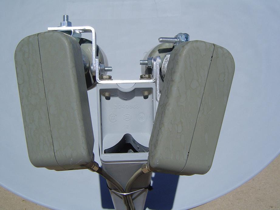

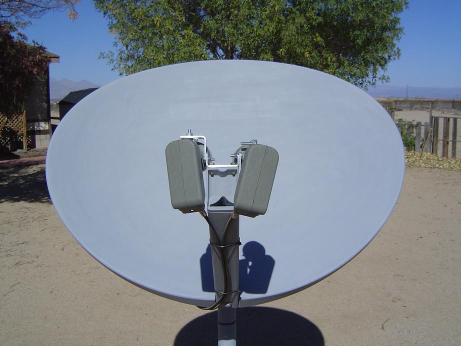

Additionally.....
I modified my P* dish for the 110w & 119w DN sats for my subscription box, I mounted 2 circular LNBF's on the arm, the signal strength & reliability has been greatly enhanced.

Nice engineering! That pipe strapping must be thicker than the stuff i have seen. and I hope nobody can see that primestar, if that's copper tubing and not brass, it will take legs and walk away! We got copper thieves down here who can actually smell it from 1000' lol
