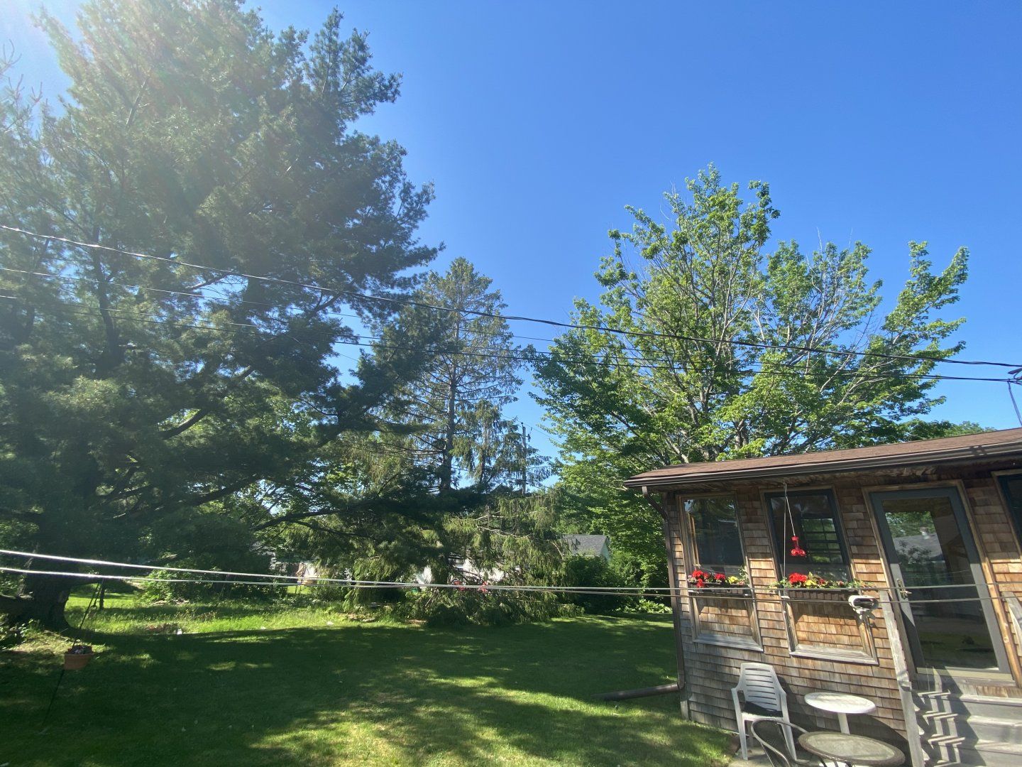

I'm in Fredericton, NB and when getting the 119 satellite my signal strength is 40-54, and there's nothing in the way of that reception, only issue is with respect to the eastern arc I do have a huge pine and fur tree in my back yard, so as I mentioned I did try to move my pathfinder x2 around all over my back yard and no luck, I mean I would've expected to at least get some signal for the eastern arc satellites, even if my signal isn't great.

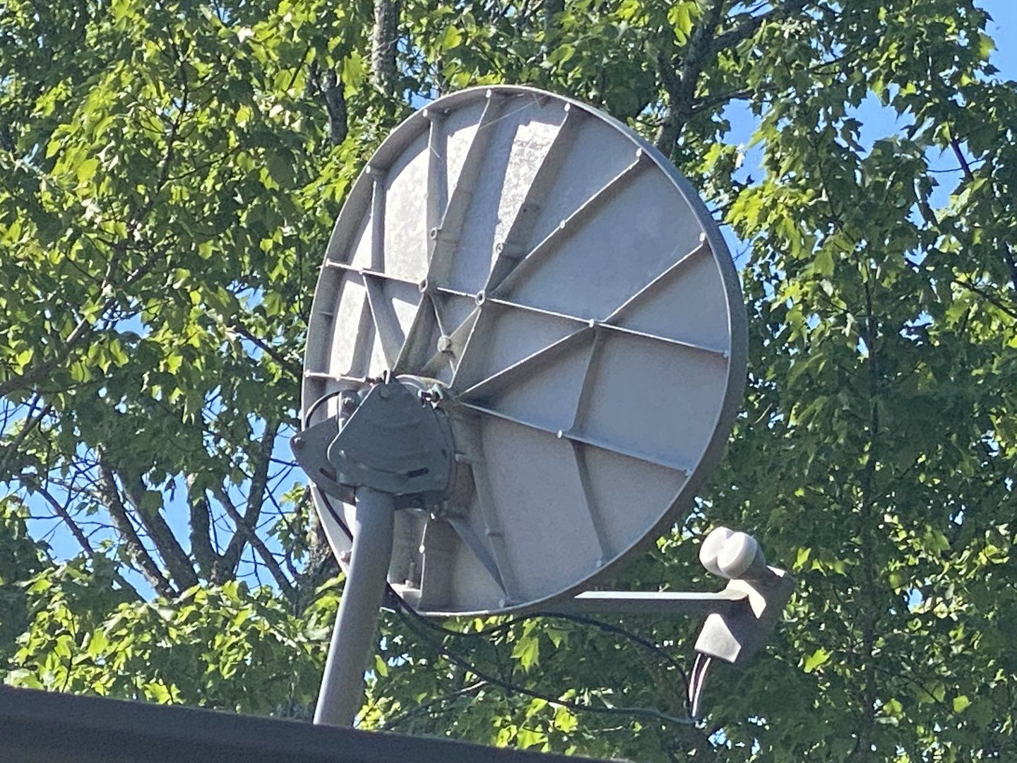

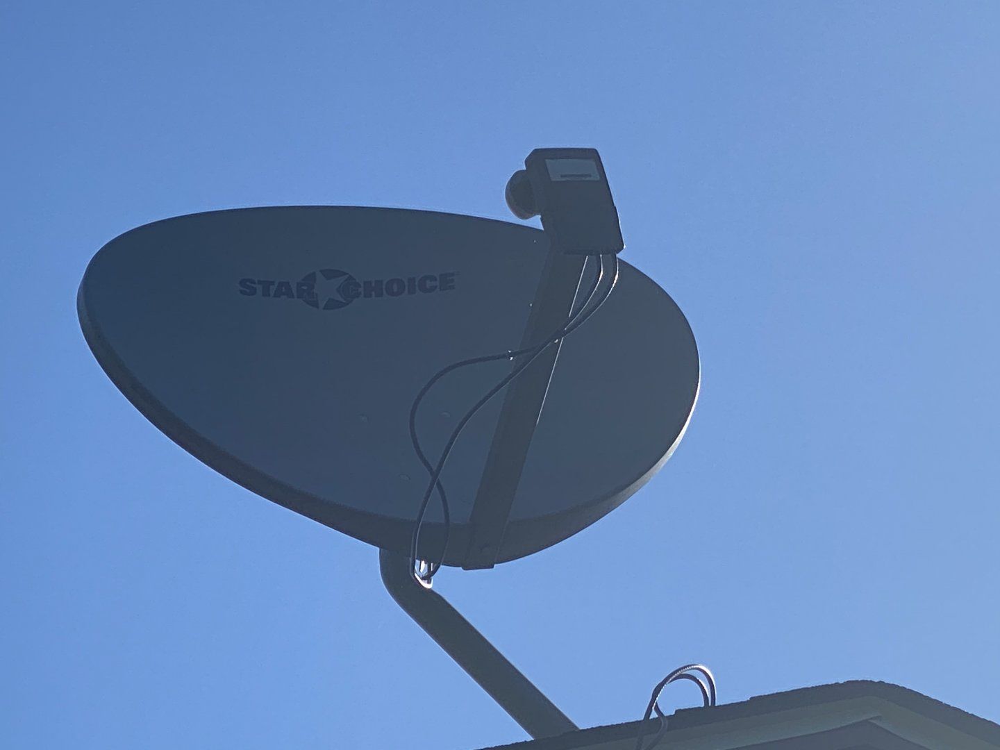

Here's the starchoice dish I've now , it does have a dual lnb, and as I mentioned in my first post i was receiving 2 satellite signals at the time.

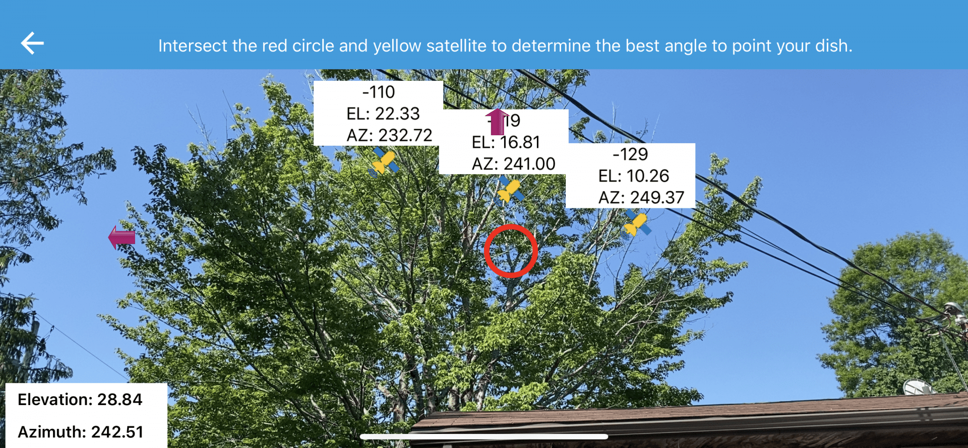

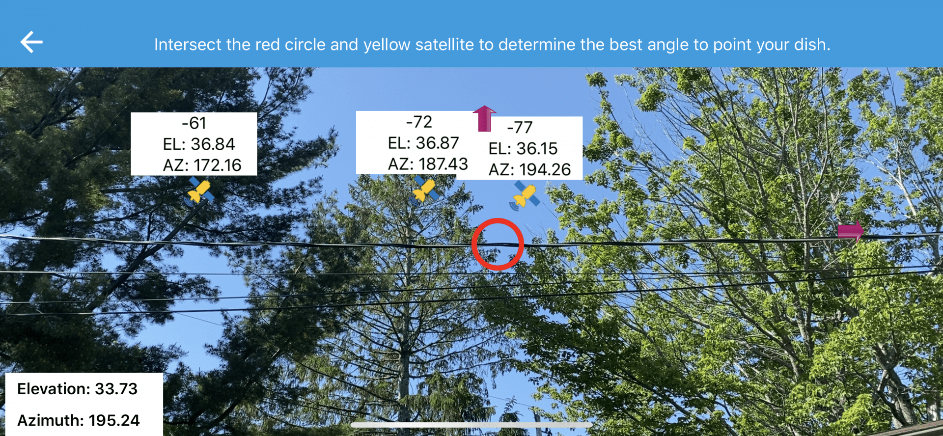

I also uploaded the satellite coordinates for dishes west/ east arcs just to see if based on the environment( trees ) if I should expect some severe signal loss?

I just wasn't sure depending on the dish I've got from starchoice if I can get dish working with it or directv( if I changed the lnb) or if I can simply move the dish and try pointing it at dish or directv satellite(s)

Any newer-model Dish Network dish (1000.2 or 1000.4) will work for either arc. You just need the specific LNB that is intended for use with that model of dish and that arc. 1000.2 dishes and LNB's are easier to find, since that is the standard installation. The 1000.4 has a larger reflector, which may help in your case if you can find a spot where it can actually receive a signal. The 1000.4 Eastern Arc LNB is also the only LNB that is designed to combine the 77 satellite with the 61.5 and 72 satellites. (The standard installation is 61.5 and 72 only.) This may be important in your case, since 77 is the satellite that you have the best shot at receiving, judging by your picture.
