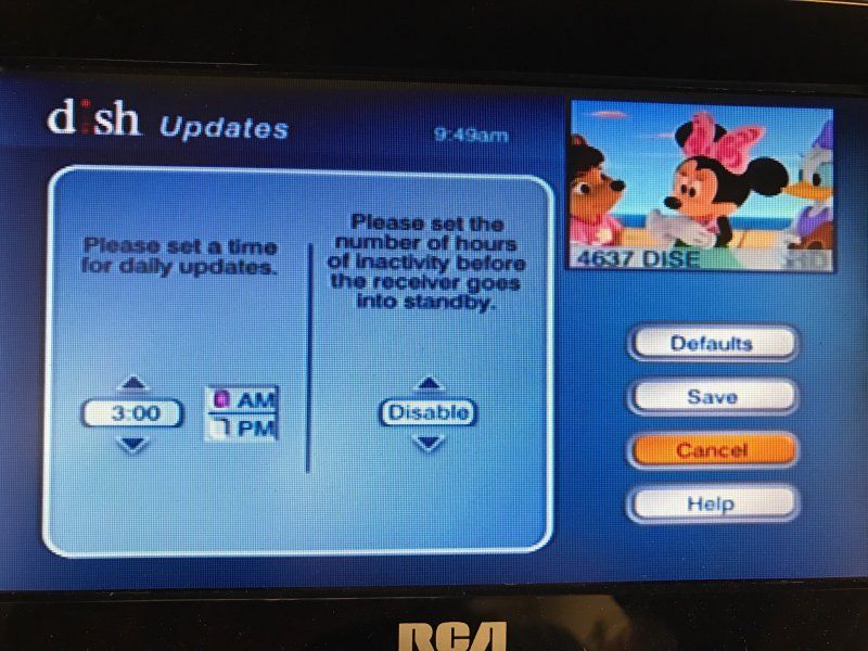

It's a vip 211z reciever and what I did so far was to find the menu option for updates which is currently set to 3:00 AM but auto power off is still set to disable (like it was a few years ago when I changed it the first time). So I thought maybe its a glitch so I changed the field from disable to 4 hours, saved and then went back into the screen and changed it back to disable again.

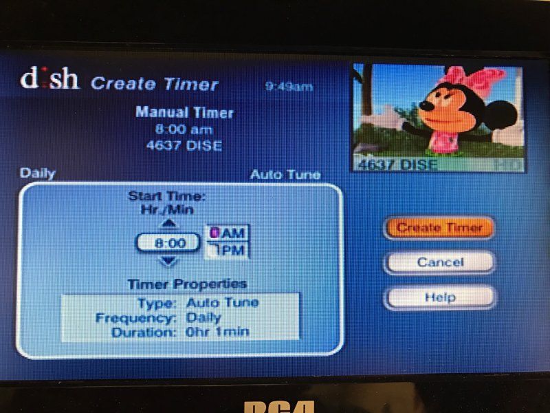

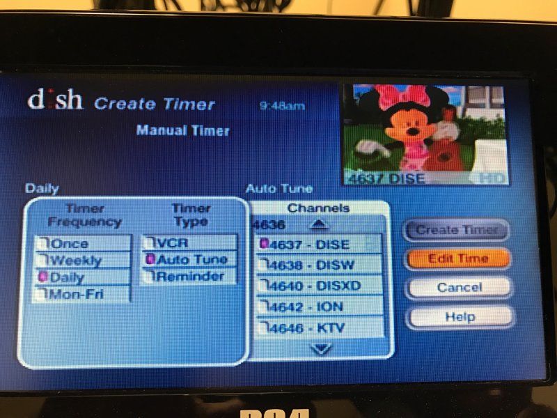

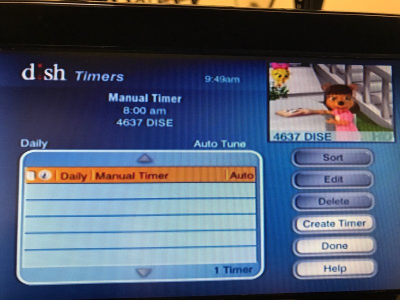

I also found the timers option and set it to auto tune disney east, channel 4xxx something (forget the confusing channel numbers) at 8:25 am daily. This way its on by their 8:30 arrival and 9 am building opening. But again today the manager told me when they turned on the lobby TV, it was not on so she had to go back into the IT room again and turn it on with the remote in there.

Your 211z will turn itself off, nightly, to update the program guide. A way to fix your issue is to set up a daily timer to turn on a channel some time after the nightly reboot. this is called an Autotune...
Bobby, I am pretty sure the autotune is set for 8:25 AM but it is not working.

Ok should these settings work?
To test, just set one identical to that for a few minutes from now, then turn the receiver off and wait.

I thought I should point out that when you leave a Dish receiver on a music (audio-only) channel, the inactivity shutdown will not occur for the rest of the day, even if inactivity shutdown is enabled. (The receiver will still do the scheduled nightly reboot.) This applies to residential accounts, not just commercial ones. I assume this feature works this way for the same reason: people like to leave their receiver on a channel for background music, and don't want it shutting down.
