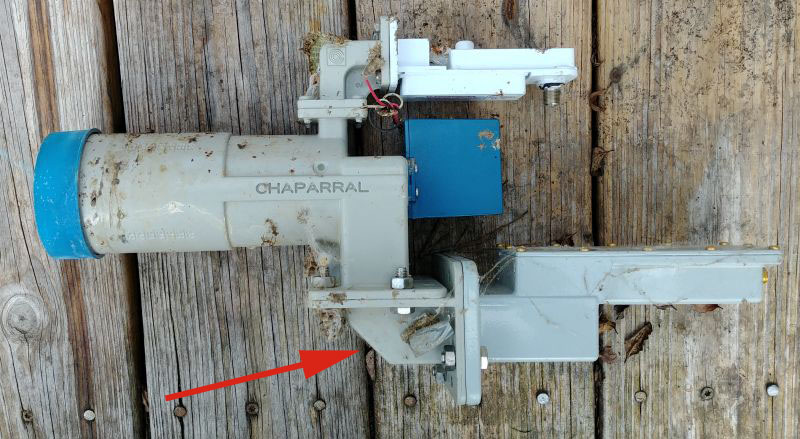

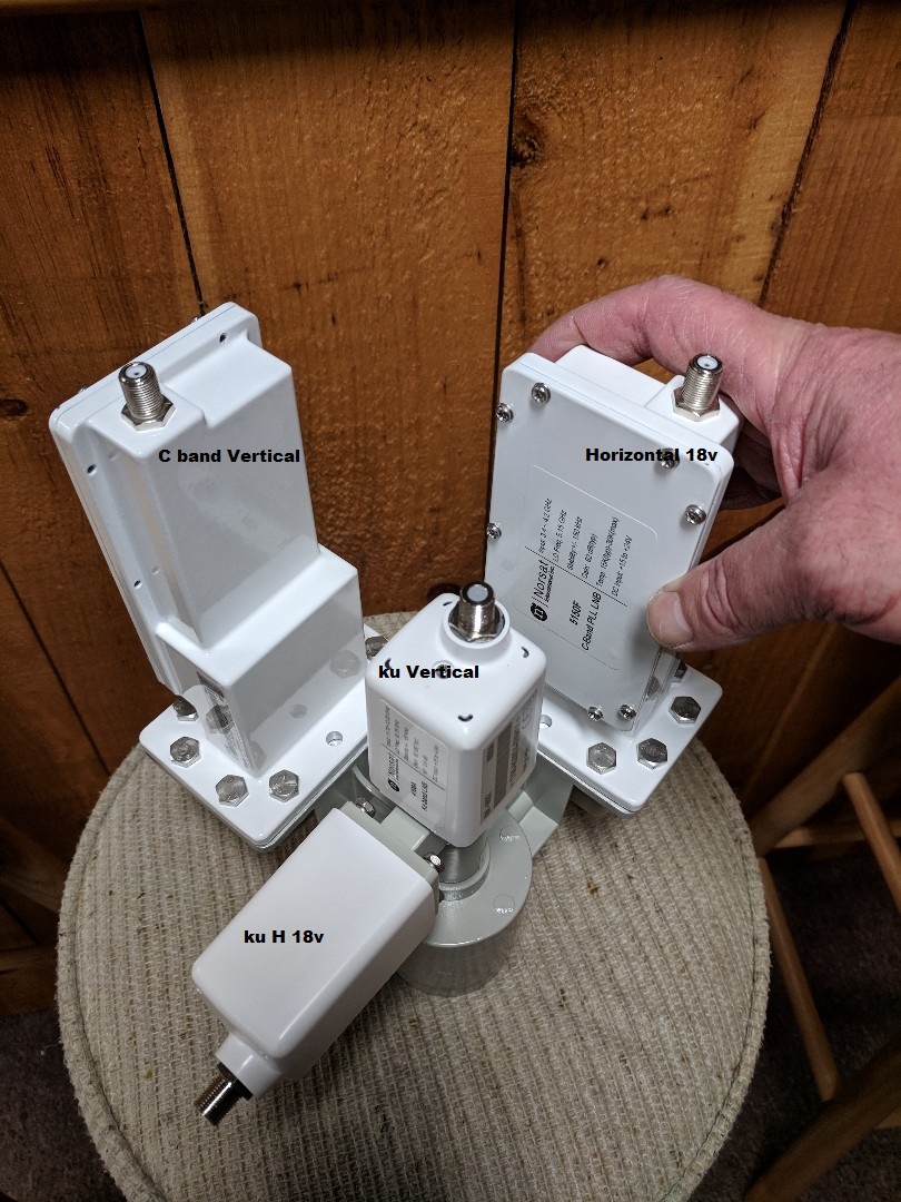

Anybody got a spare KU band wr-75 elbow I could use on a Pansat ortho feedhorn to connect a KU lnb so that it would extend UP instead of out one side of the feedhorn?
If so, let me know what you need for it, free/cash/Paypal or maybe trade of something?
Reactions: Melvinfta
No, the little elbow at the TOP (above the word "Chaparral") that goes to the KU lnb. Along with the screws.
The photo is a little bit deceiving I think.

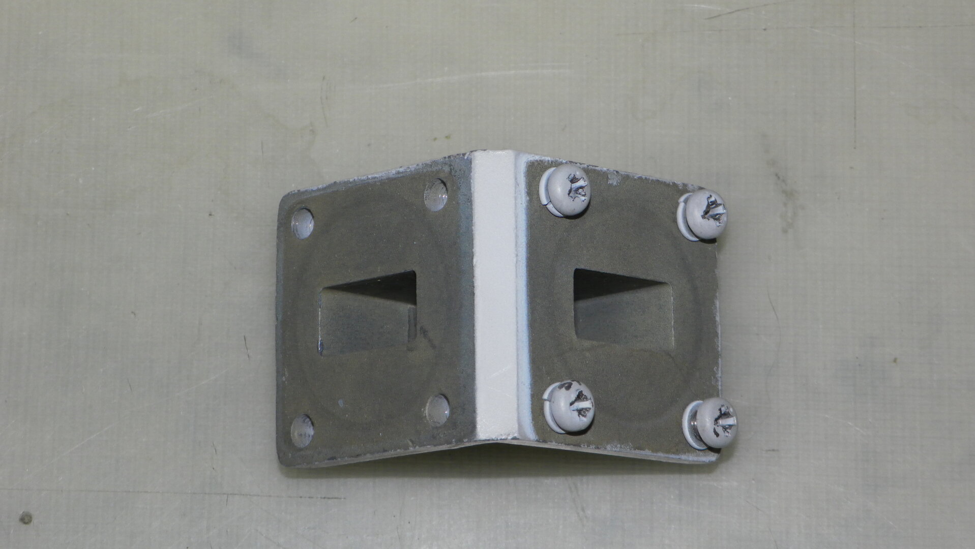

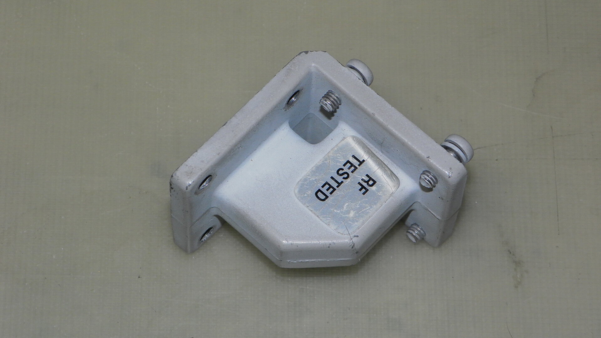

This is the one you want I believe. The business ends are in this pattern.

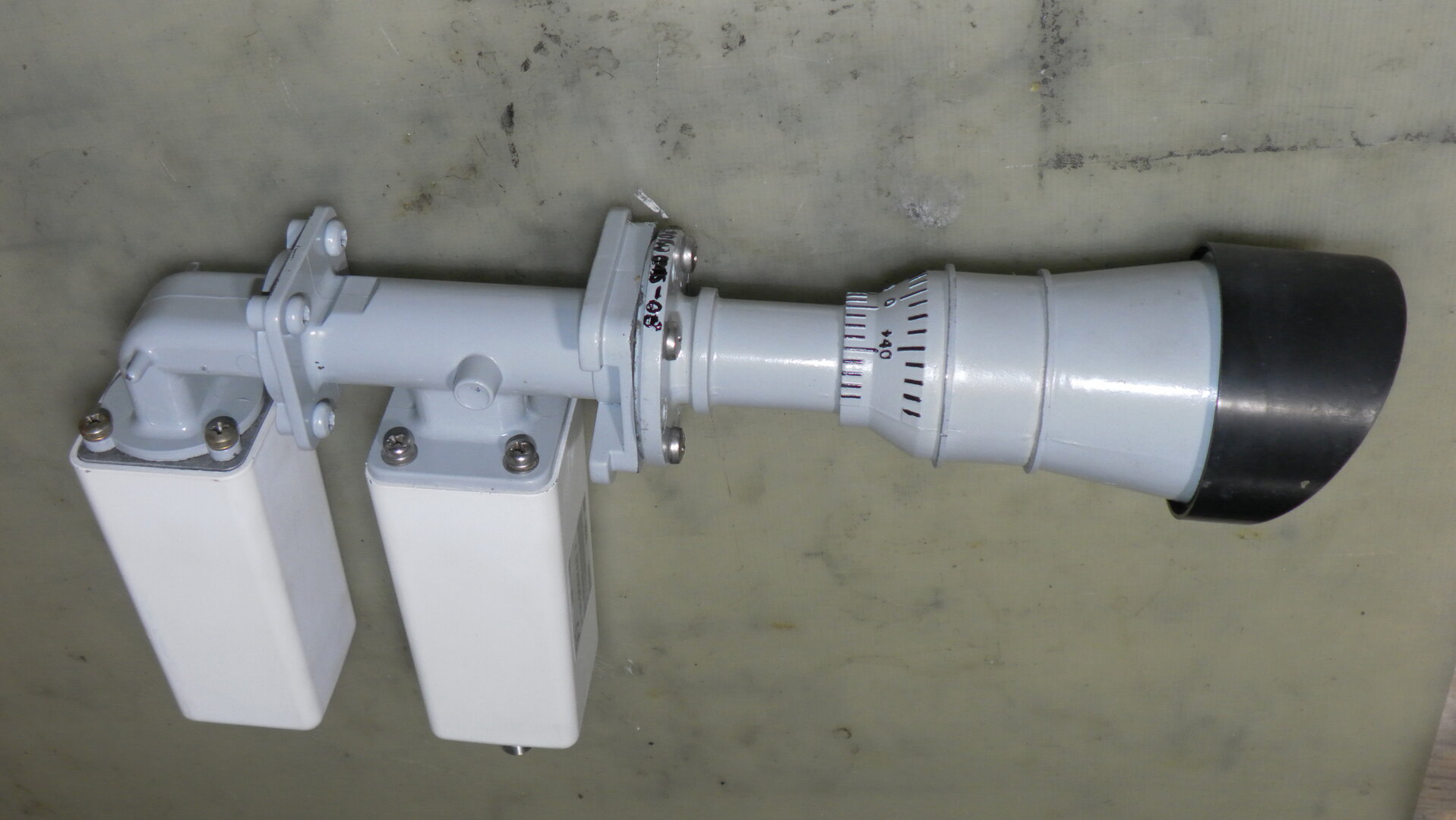

The one RG41 has is bent the other direction.
Reactions: primestar31

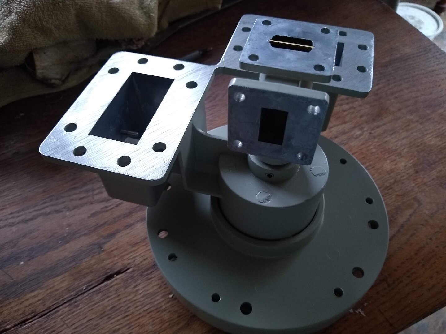

Yes it's what I thought. I stumbled into that same thing with a Ku ortho feed I put on an old PrimeStar dish. The feed came with a vertical bent elbow so the LNBs pointed down and away but I was thinking to put the original LNB cover on the dish and needed both LNBs to point straight back like you have with yours.

You'd think that with the cost of that feed, they'd have included an elbow. Well, guess I wait to see if Radioguy confirms which way his is, though it seems from the photo, it would have to be vertical instead of the needed horizontal.

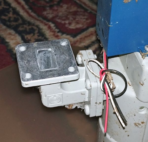

Another thing to consider is how it attaches to the feed. In your case you need the elbow to have one set of threaded holes.

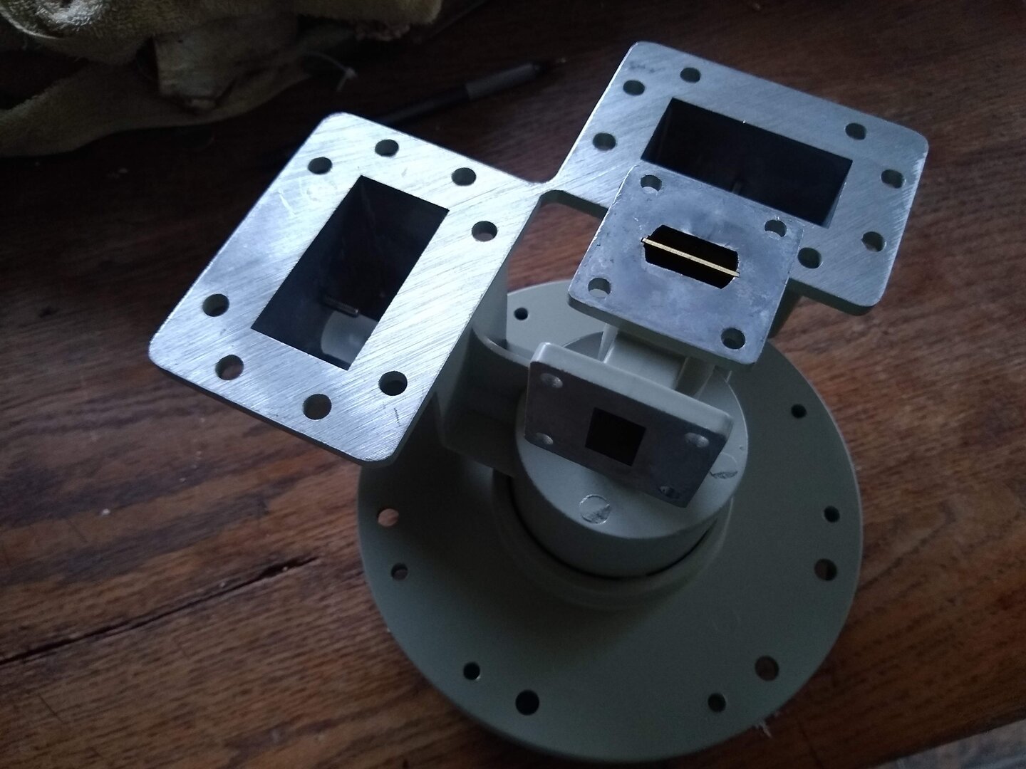

IF I find one with the right orientation, yet it isn't threaded, couldn't I use slightly longer bolts, and just put nuts on from the other side of the flange? The feed flange holes are very accessible on the other side, though it may be hard to tell that from my dark photos of this morning.

I imagine that might work. I think the elbow I have came from a Wild Blue dish setup.

I just want to be able to put the lnb cover back on and over the feed. With one lnb sticking out the side like that, I don't think that would be easy.
