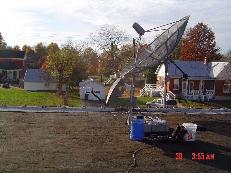

I also currently have a 10' mesh BUD but am going to change it out for a less wind stressed 7.5' Perfect 10 dish. You can see the 10 footer and how it is mounted in my avatar. The only problems I have had with the KU part of the signal is when the wind blows and the old 10 footer has structural sway that loses the signal.
Other than that the Eagle Aspen has worked well for me.

The top of the mast is currently about 20' from the ground.
When I put in the replacement dish, I am going to chop off about 18" from the top of the mast, and the replacement is a 7.5 footer which will bring the total height down about 3 feet.

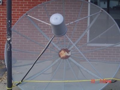

Here is a pic of the current dish from the roof level.

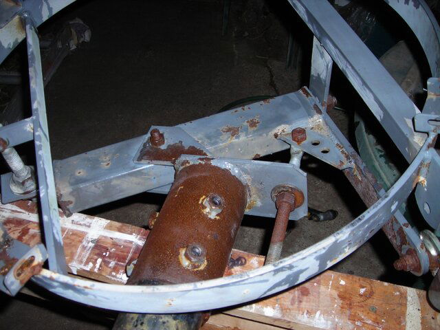

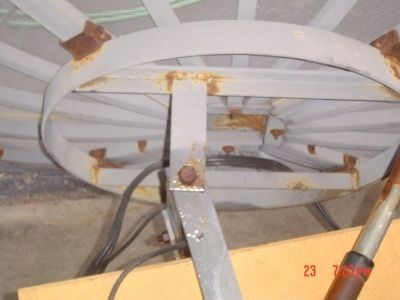

Here is a pic of the replacement dish.
It has a polar mount that is not in the center like those mentioned above.
I have sanded all the rust spots and have repainted this dish in preparation for installation just as soon as the weather breaks for real.
Cool, you should move that to the "Big Dish's" post and we could have a going picture library in a thread, specific to big dishes, which should then be made a sticky :D
Anyway, I have that same exact dish, that a family member let me take down last week. Im going to post the pics, when I get to taking them. I'm also treating the rust with multiple treatments of rust remover. The actual pole mount suffered the most. I'll say how I ended up taking it down, because I couldn't reach it, in the other thread when I post the actual dish pictures. Need to replace all the bolts, because 80% of them just twisted off, even with WD-40 and Nut Buster.
