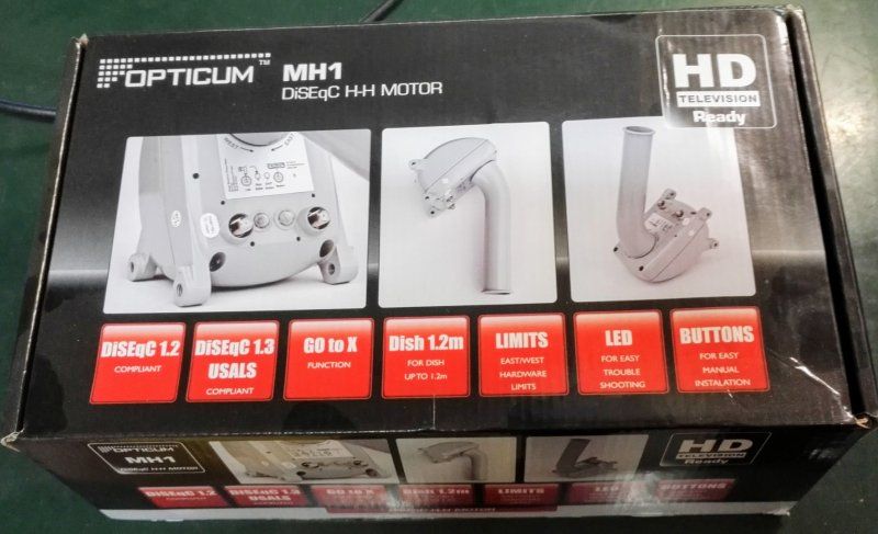

Even if you are going to hang 90cm dish on the motor, I would say, it is better to have more powerful motor. I recently bought such a motor, it has metal gear inside, and, BTW, cost less than 50 bucks. I have installed heavy 1.2m Channel Master dish on it. IMG 20170202 215843 Large
If you wish, I can pick up another one in the shop and send it to you. Total price will be not more than 78.99 (including shipping) :)

Even if you are going to hang 90cm dish on the motor, I would say, it is better to have more powerful motor. I recently bought such a motor, it has metal gear inside, and, BTW, cost less than 50 bucks. I have installed heavy 1.2m Channel Master dish on it. View attachment 124491
Do you know what size the shaft is on that motor? My dish uses a 42mm shaft, but it looks like the STAB HH120 would be too large.
