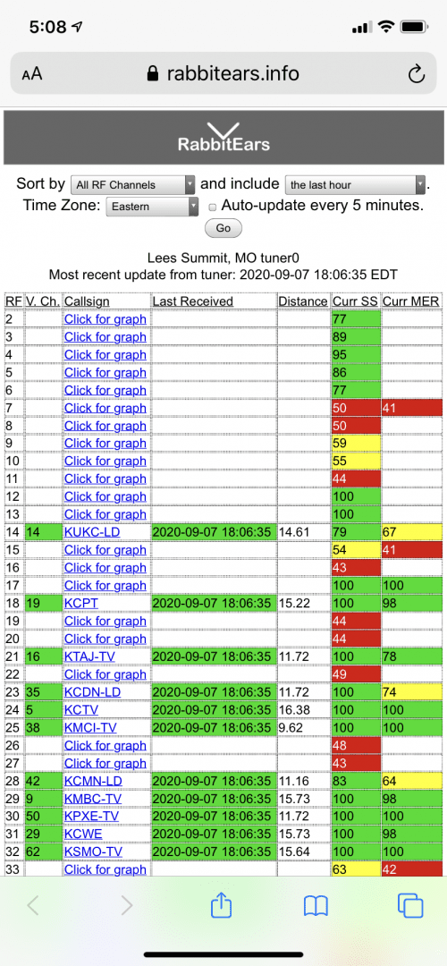

RabbitEars data on KUKC still shows just 4 subchannels and the TSReader Data that could tell the format of each subchannel is dated back to 2021.
TSReader Lite is free and runs on Windows but I don't know if it can see the feed from the Recast. I use it with HDHomeRun tuners.
