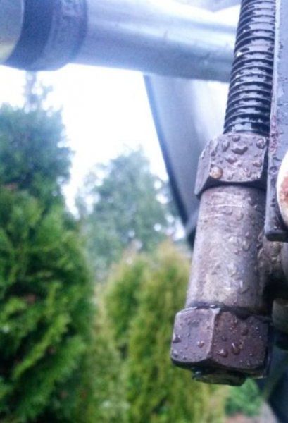

Here's the elevation adjuster. Not much thread left. No idea how these would have been installed up north, unless if it wasn't motorized then you could crank the elevation and drop the declination.
it doesn't take a lot of vibration to walk a nut down a rod, especially when it's nearly vertical. A lot of the vibration caused by wind blowing across an object isn't audible, but it can be enough to move a nut a little at a time until it eventually goes off the end of the threads. I get a little over zealous when I tighten nuts, but so far, I've never had one come loose. In applications where it requires something to be at a certain point, I use lock nuts.
When I do, I only use the ones with nylon inserts rather than the nuts with indentations in the threads. They damage the threads. I'm glad yours didn't work its way off the end of the rod. It could have done a lot of damage flopping up and down in the wind. :)
