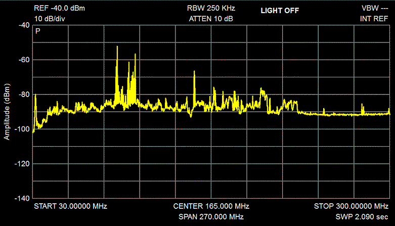

Here is a pretty good article on the issue along with graphs of RF noise with the LED bulbs on and off:
http://www.ledbenchmark.com/faq/LED-interference-issues.html
