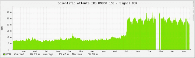

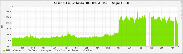

Looks like there was a slight increase in BER on Tuesday, and Friday the BER jumped up to what it is now, from what I can see on the graph. So it might have gone full power Friday night. What's interesting is that I can pick up the last two vertical HITS transponders on 105 with enough signal to produce a stable picture if they weren't encrypted. Can anyone confirm NASA TV illuminated around that Tuesday night?

The 1st post I saw from anyone in regards to NASA being lit up was Dec 1st early morning
This answers my question. I do apologize for my silly posts. NASA TV is to blame for our reception issues. The only solution would be to get a bigger dish antenna. Hopefully the replacement of AMC 1 would make a difference in the future. All I can say is it sucks, I cannot fit a 2.4 meter dish antenna in it's place.

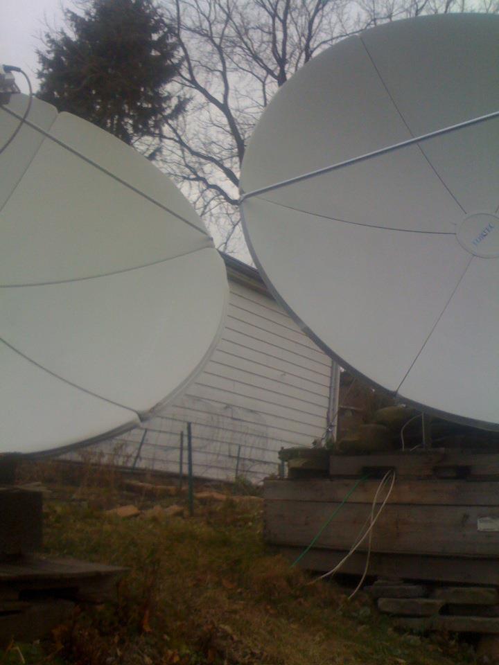

I'm still trying to figure out in my mind if a 2.4m dish would work. With it I'd be able to pick up PBS as well as DW-TV, ION, and some other rare goodies. I peaked it for DW-TV so other stuff never came in, but I just wanted DW-TV. The outside of the larger reflector would stick out about 4 inches or so into the outside of my other 2.4 meter, which might cause issues.

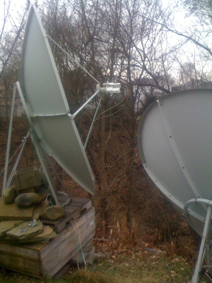

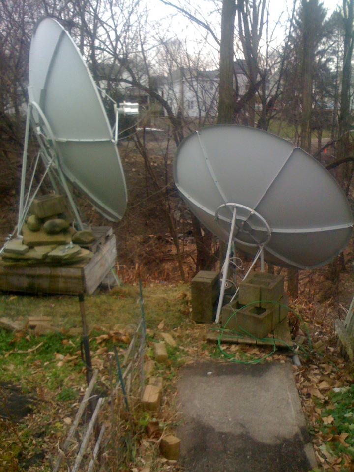

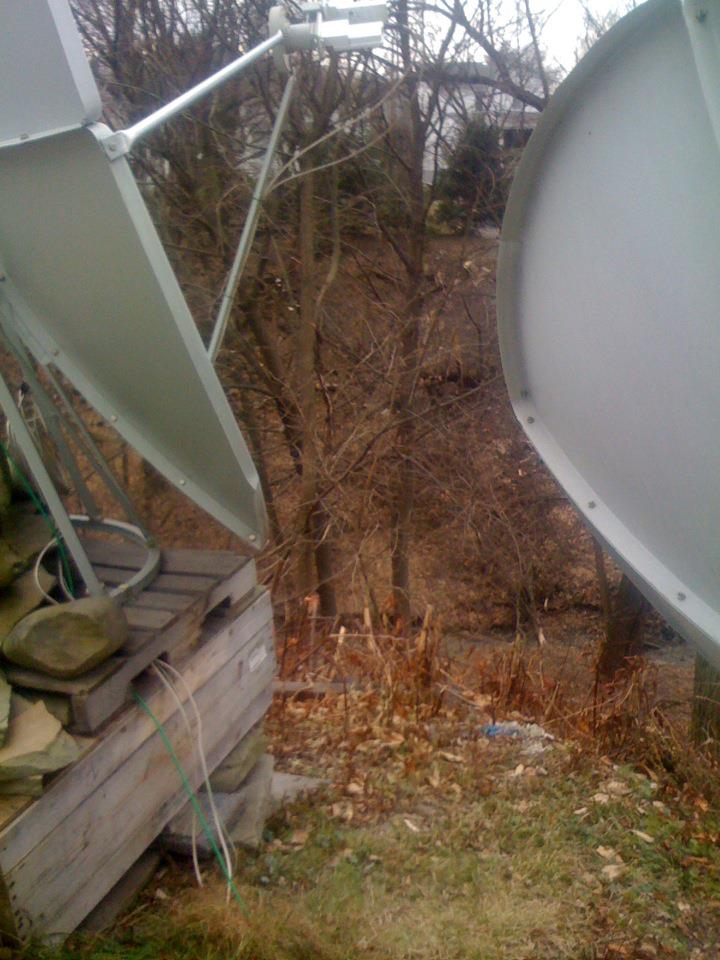

The feedhorn of my 2.4m had to be in an odd spot, towards the top right of the reflector, to get the strongest signal. I don't know what is with these Fortec 2.4m dishes, but they suck. Good thing the LNB support arms bend, because it was the only way I'd get any signal, no matter where the dish is pointed. The panels are not bent, I really have no idea why the focal point isn't where it should be. It's pointed at 131W, QVC comes in really good with strong signal and low BER, but C-SPAN still has sparkles. Here are my 1.8m and 2.4m Fortec Star dish antennas:
403032_2893720541131_1203828635_3183741_1192773367_n.jpg375546_2893727741311_1203828635_3183746_2013303478_n.jpg395703_2893732821438_1203828635_3183749_1427998929_n.jpg406023_2893739421603_1203828635_3183753_1897674811_n.jpg
The feedhorn and scalar ring on the 2.4m don't look right, thats because I had to move it there to get the strongest signal, I really don't know why the focal point is off. I really don't think there would be enough room for a 2.4m to replace the 1.8m, what do you guys think?
I dont know what to tell ya but I do have one comment on how you keep those dishes put
I thought mine were ghetto with the sandbag on the 2x6 that goes across the bottom of the dish...yours top that ;)
It looks like you have the feed incorrectly centered on the dish. Maybe your az & el were off on them and you just wound up adj to hit the 1 bird. Do they make polar mounts for these dishes?
