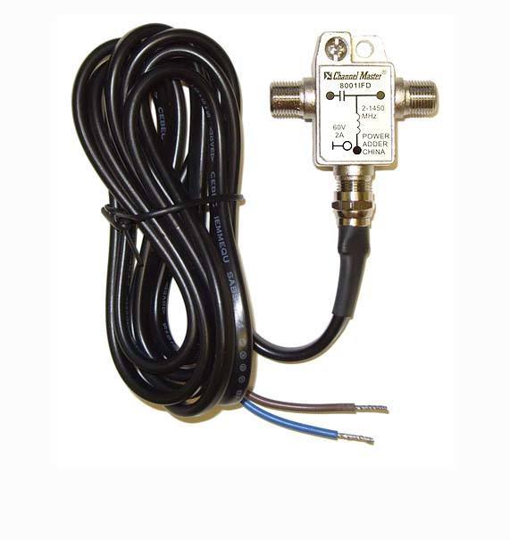

I have a line coming in the house to the VS Platinum. It works fine in the front room with beautiful picture. I tried to move it up to the bedroom but it doesn't get any signal. I hooked the coax to the "in the house wall coax" that starts in the front room and winds up in the bedroom. I'm pretty sure it's the only two hook ups to that run of coax. It works fine when I use the "TV Out" of the Platinum. I'm guessing that the coax run is just to far and it loses enough power to not be able to run the Primestar LNB.
Is there a power amplifier or power inserter or something I can use to over come the coax length?
Maybe something like this?

how long -is- it ?
I'm with RV1pop on this.
If you have the typical home splitters in the walls or attic, there is no amp nor inserter that'll cure the problem.
You need a new, clean, piece of RG6 to your receiver.
There isn't a work-around.
Now, you might find something interesting behind the wall plates, so it's worth looking.
You might find a broken cable or bad connection behind one of the plates, so it's worth a peek.
But if I understood your comments correctly, then maybe not.
(You put the channel 3 signal into the house cable and got it in the bedroom?)
Never trust electricians
It's frackin RG59 (even though I specified RG6) and when I pulled the face plate off, there was a splitter in the box! :mad:
I took out the splitter and figured out which lead went to the bedroom and hooked it up and it worked. Now I can have my Platinum in the bedroom.
In my new house I will have conduit up to a box in each room so I can change things whenever I want.
Oh well.
Thanks guys
