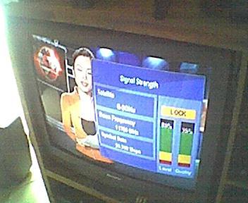

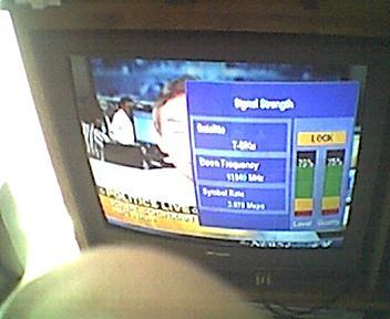

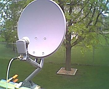

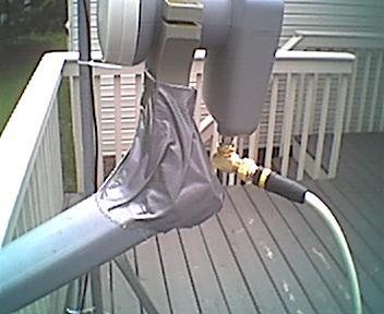

I've been able to get the strong stuff on 101 (KUIL, 3ABN), 95 (CCTV), 93 (Doc Scott) and 89 (ABCNews stuff) with a 18" dish :)
(last pic shows the 101 LNB wedged on a Phase II dish between 91 & 110...when both actually had some FTA channels
While Sadoun is right that a 24" isnt reliable for KU...its fun as heck to tinker
Thats why we can get strong KU signals on a 18" or Phase II doish and why we can get some strong C-Band stuff on a 1.2m dish and even a 40x30 primestar. Because it pushes the limits and is fun :)
