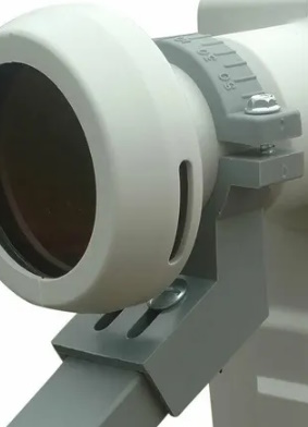

I need the following LNB bracket to fit my Star Choice dish. I currently only have the original 50mm bracket. I need the equivalent 40mm bracket so I can properly mount my LNBs.
Does anybody have one in their junk box or know where I could get one?

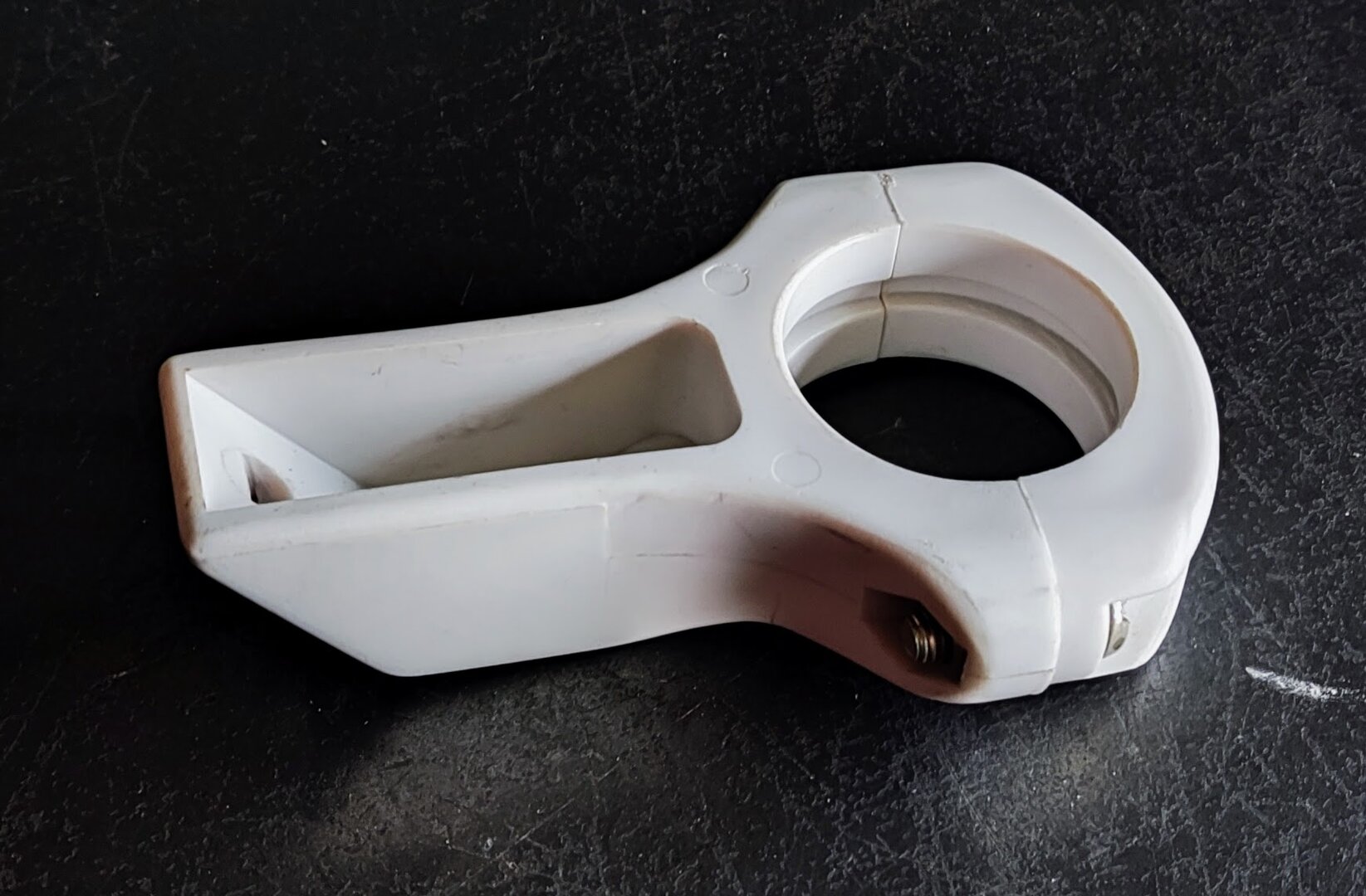

Thanks, but that's not the correct one. Note where the bolt is inserted. Yours has one hole. I think yours fits the Geosatpro dishes. But I need a wider holder with two holes. Mine is unusual and is only used on old commercial dishes like Star Choice.

That's the bracket used on this Winegard dish, sold by Solid Signal:

Hello all,
I know this is an old thread, however I need this LNB Bracket since mine broke in the spot where the screws attach to the dish. If anyone can assist, please let me know. Thank you so much.
