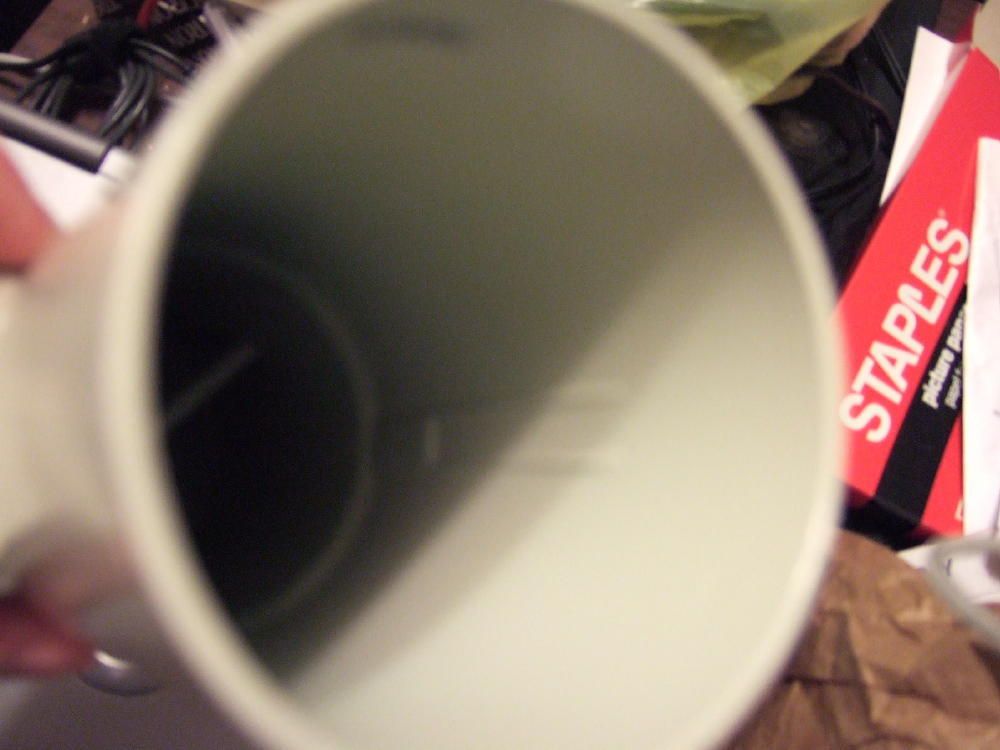

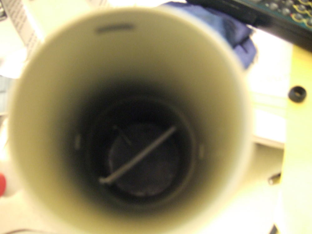

both of my feedhorns have slots about an inch inside the feedhorn about where the scaler # start exactly inline between the h & v probes ** note its not between them , the probes are 1 inch and 2 inches above where the plate would go.
heres a pic
i have a dielectric plate also but will have to find it and i will post a pic of it.

On the LNB I have, there are no slots. But, is the dielectric plate supposed to 45 degrees to the antennae inside the feedhorn? Does it work if the dielectric plate does not extend all the way to the back?
It looks in your pictures that the dielectric plate is 90 degrees to the antennae.
