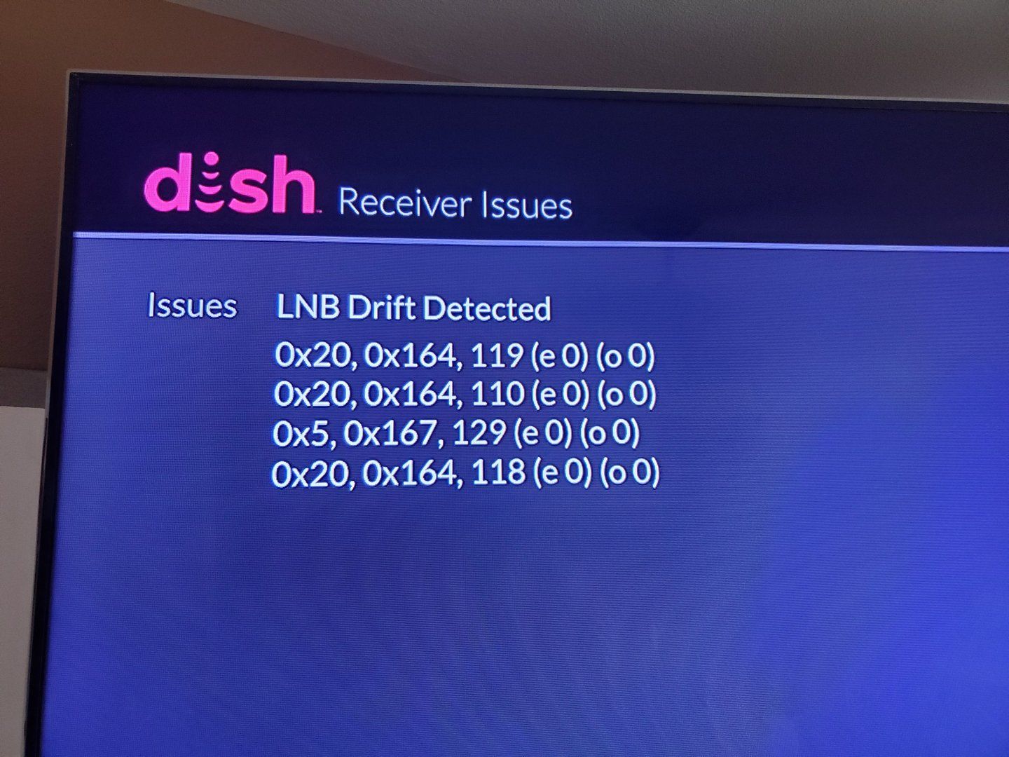

HipKat what is LNB Drift? Here is a pic of my LNB Drift Detected screen (Diagnostics, Status, Issues) from my Hopper 3. Does the 0s mean my LNBs are OK? Thanks.

It is a software bug that has been there for at least the last couple of versions. I see the same thing on my Hopper Duo, and several other people have reported it, too. For now, it is best to just ignore it, unless you are actually having problems with your satellite reception.
LNB drift is a shift in the oscillator frequency which prevents the LNB from properly tuning to a transponder. Dish receivers can make up for a small amount of LNB drift, but when it gets too high, the receiver cannot compensate, and the channel you are trying to tune to will cut out.
Many years ago I actually had LNB drift. It was related to heat. It was summer, and during the day when the LNB heated up, the drift would increase to the point where the channels would cut out. At night, when the LNB cooled off, the channels would return.
If I remember right, my receiver (which was a 722 or 722K) was able to compensate for a drift of about 7 or 8. When it was higher than that, the channels would cut out. Once I replaced the LNB, the drift went to zero and was not affected by heat.
Since your LNB drift is shown as zero, I don't think that you really have any LNB drift, it is just that software bug that everyone keeps referring to.

If your Check Status screen says No Issues Found when you run it, I wouldn't concern myself with it.
I agree. If the Check Status results say No Issues Found, then you would have to be really obsessive-compulsive to go ahead and click the Issues button anyway, to actually see this bug. Having said that, I have actually done that so many times. Perhaps if the results say No Issues Found, the software should just automatically gray out the Issues button. That would fix this problem for sure. :eureka

The LNB drift warning is a software issue with the H3. There is at least one other thread here discussing it. It was not fixed in the most recent SW update released on 1/12/21.
From that thread:
This false error will be fixed in the next software release scheduled for the beginning of December 2020.
So apparently it was fixed in the December software release, and then broken again in the January software release. :biggrin
True. I was simply judging by the fact that there were no posts in that other thread in December. Then, all of a sudden, immediately after a new software update in January, this issue gets revived again in a new thread.
Whoops, never mind. I just double-checked, and the last two posts in the other thread were from late December.
Never fixed in the first place.
