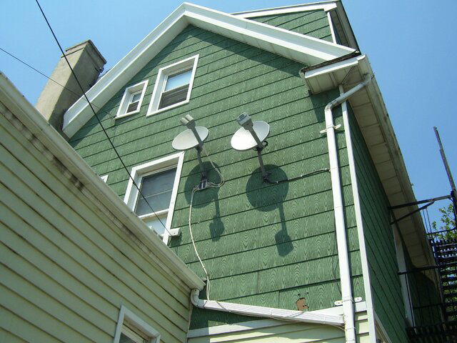

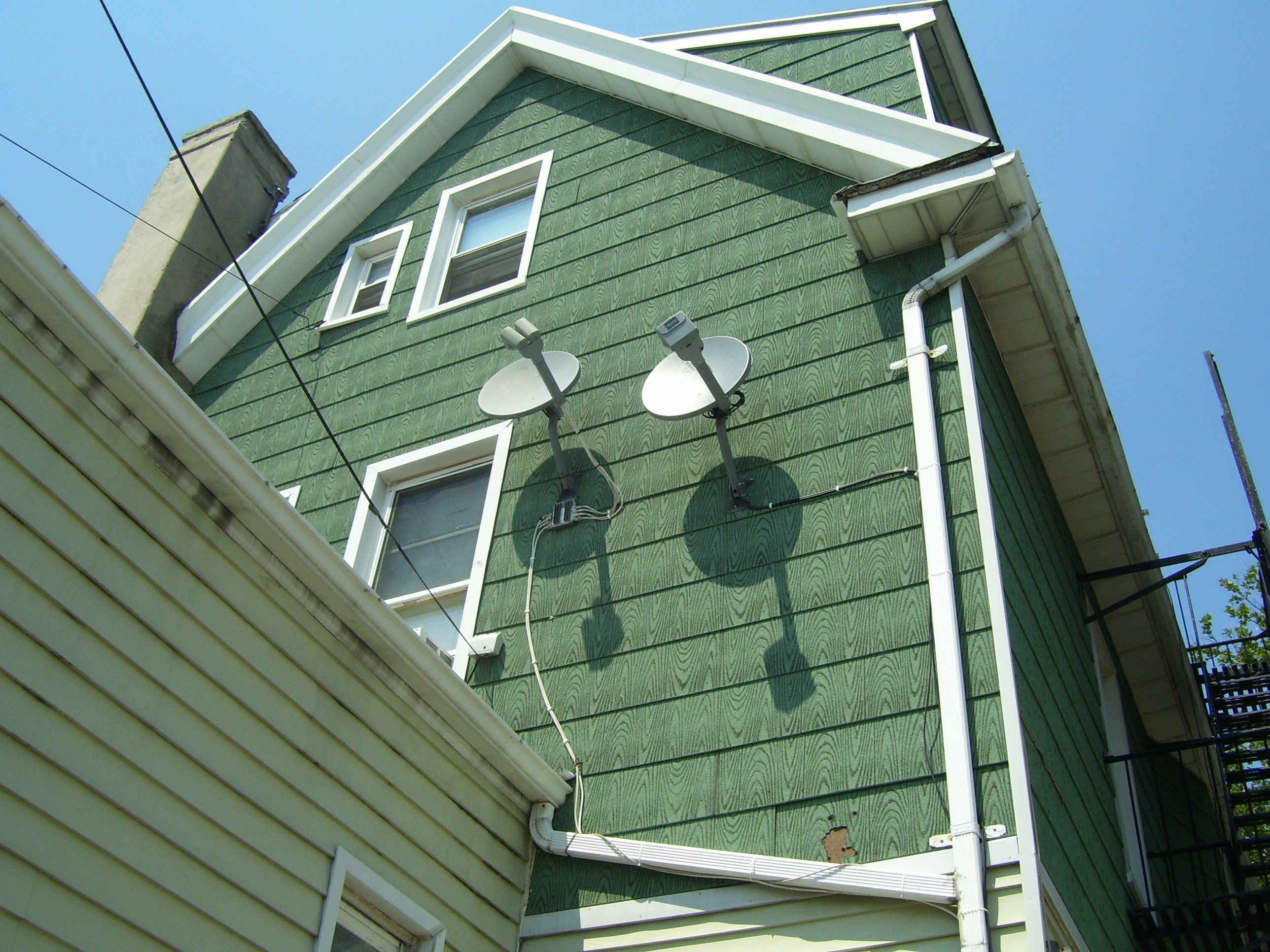

It's a coax cable. I took a picture and it gave me a better perspective since it's high up. I believe the wire looks like it is connected to the new dish but it is not. I think he cut the wrong wire when he first set it up. (The cable to the other room runs through the room with the 721.) He had to hook it up in the other room by accident because the first time around it was still picking up the sw44 switch and not working. The wire seems to be connected with screws.. or maybe a barrel as someone explained above.

Well I took a picture and it gave me a better perspective of it. The wire is a coax cable but it looks like it goes into the new dish but it doesn't. I believe it looks out of place because when the guy first installed it he cut the wrong wire and hooked up a different cable to the new dish. The wire now looks like it is connected to a barrel since it seems to be connected by screws.
Where's the picture? :)
Here. :) The one on top is the old dish and the new one is under it.

Eck and I though the installers here were hacks. White cable is not good for outdoors, no UV protection. Is the wire to the 721 all new then? Its white so im assuming its a old wire.
I can only see a few possible problems here-
1. The 721 is bad - sending too much voltage to the DPP twin. This can be checked with a voltage meter.
2. Bad electrical outlet the 721 is plugged into.
3. The wire to the 721 is bad or has a faulty barrel/splitter,etc.
4. Dish is not peaked on 110
You can test all 3 of these. I would double check the line to the 721 and make sure there are no splitters and low frequency barrels or ground blocks.
The 721 outlet can be checked by getting a outlet tester and you can put a voltage tester on the coax sat line to see what voltage is being put out.
What are you getting for signal strengths on 110 ?
What an awful wiring job. Wires hanging everywhere, a barrel connector in the middle of one, zip-tied to a gutter, wow. That's awful.
And two dishes pointed to the same location? Wow.

I think WiCkeDuDe has given the OP enough homework to do. By looking at the hack job that the installer did, I'm thinking there's a barrel connector somewhere that's not rated 3 Ghz. There's a barrel connector in there but that's for the Legacy switch and lnbs so a 1 Ghz could work but for Dish Pro you must use a 3 Ghz barrel connector. They're easy to identify because they are blue, green or red where the cable enters.

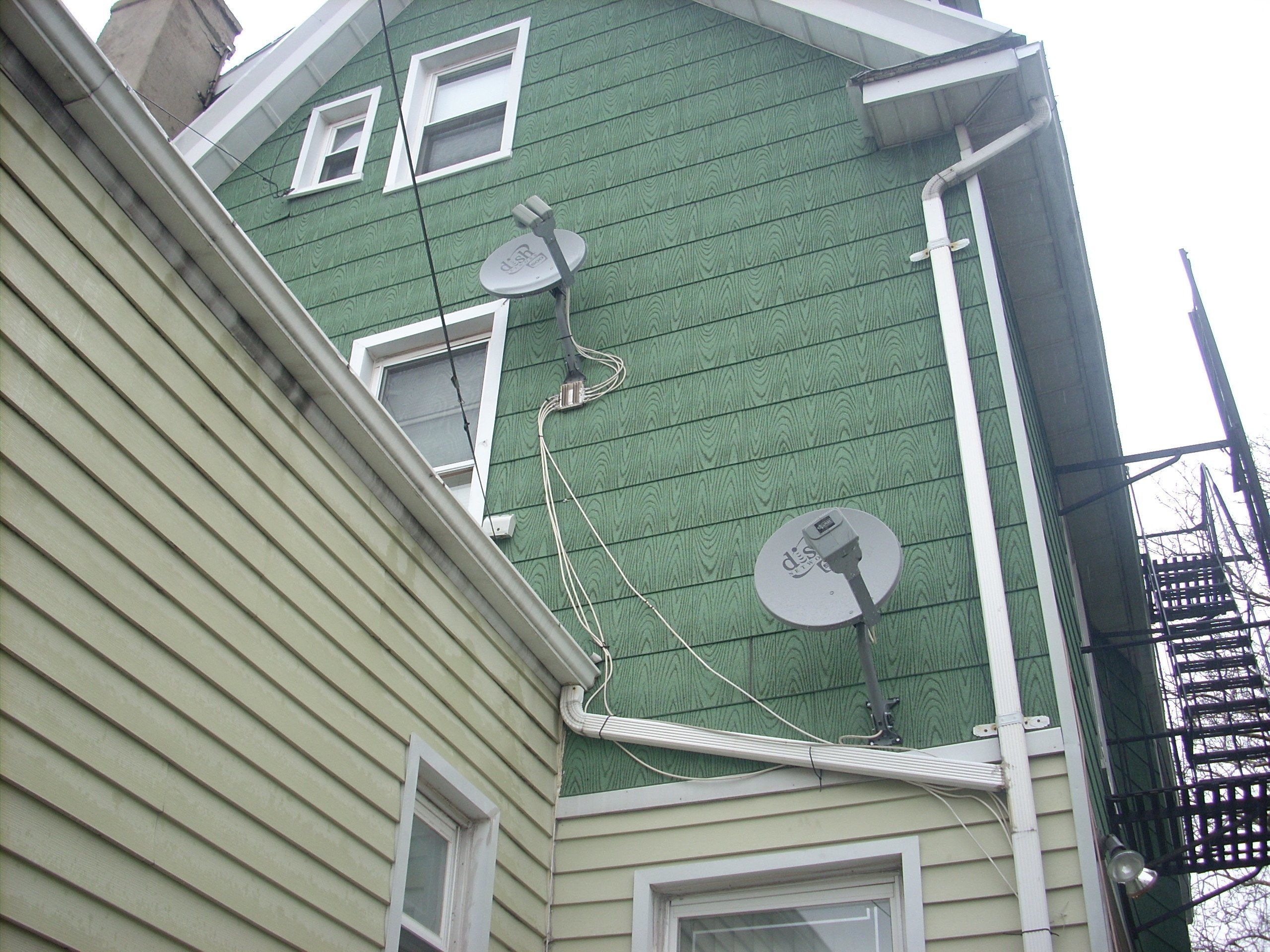

Well can you believe that it held up for 2 more months until the problem happened again. Well this time Dish Network sent out a guy who knew what he was doing, well sort of...
At first he was trying to say my receiver was shot. I told him let me take one of my other boxes and show you that it's the line. Well sure enough it was and he finally went out and I showed him the Barrel.
He was a very nice guy and changed all the wires (on both satellites). He said the first guy who put up the second dish had no idea what he was doing. He said the dish was close to falling off. Anyway here are some pics.

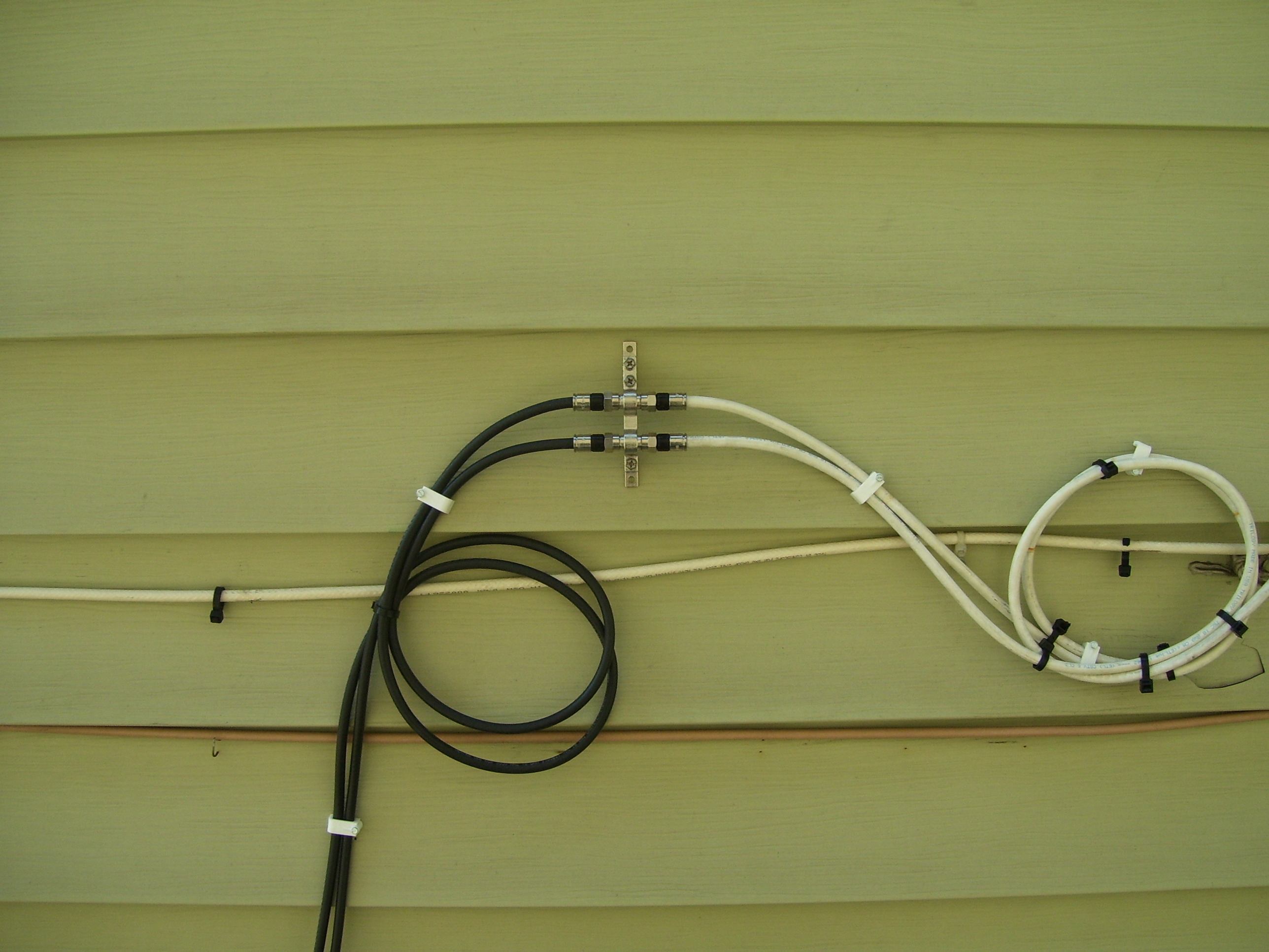

I actually have a question, what is that setup in the second picture called, with the coax wires connecting together.. He actually put another box on the second satellite, so each sat is going to two receivers.
