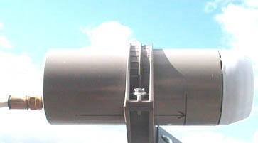

does the LNB look like this?
If so it will work there is just some tweaking that needs to be done in the settings :)

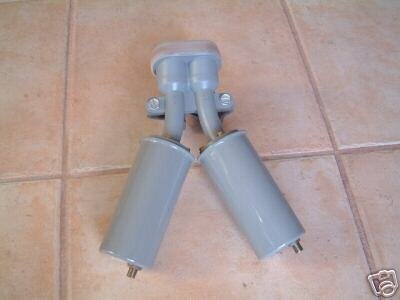

Iceberg, that stacked LNBF looks like it would fit nicely into the SatelliteAV four-degree double LNBF holder (it seems to be built like the bullet LNBF they recommend for that holder). The fact that it is stacked would also present some advantages. Are these available at a reasonable cost anywhere?
that is it ,the only diference is i have 1 cabel out .....what do i have to do in the setings?soory for all the questions im kinda new at this.....

The flashlight LNB is called that for a reason...its huge. The holder for it is a 50mm holder so that LNB would probably take up the whole 4 degrees :)

On a stacked LNB the verticals are the normal as what is in the box or you'd see on Lyngsat. So try and aim the dish with one of the following transponders
12177 frequency
V polarity
23000 symbol rate
or
12146
V
22000
You didnt list what receiver you're working with but in the LNB setup it needs to be standard with a LNB LO of 10750 (NOT Universal). Also have you skewed the LNB properly? When working with a fixed dish you need to skew it for optimum signal. This depends on location. If you give us the general area of where you are we can give you the correct info for aiming the dish (elevation, azimuth & skew)
I like "beer can LNB" better, as a flashlight can be any size! Actually, mine are more the size of a "tall boy" beer can, but you get the general idea!
