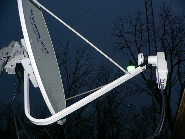

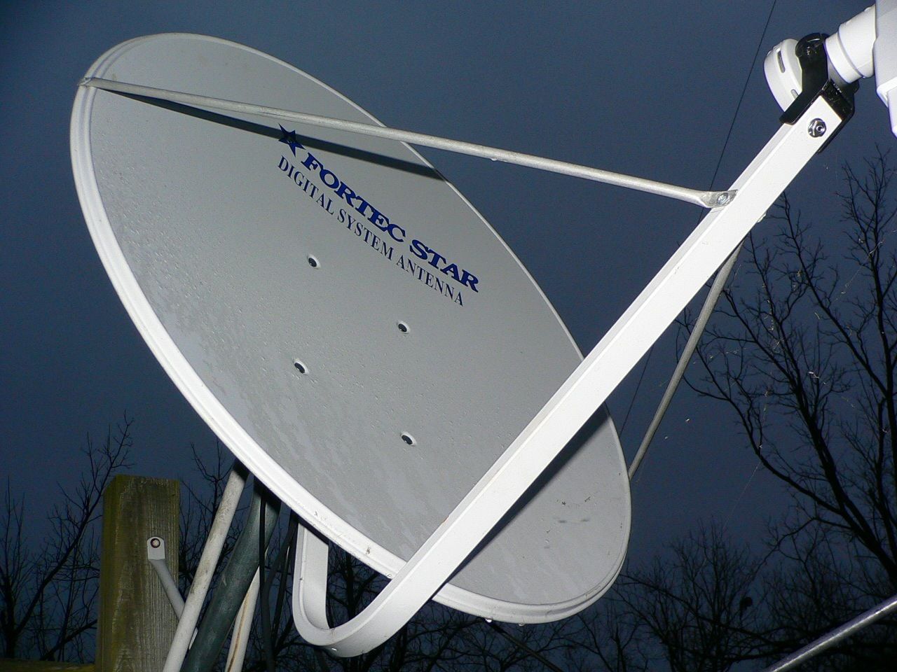

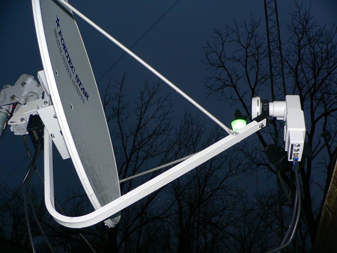

I had an Invacom Quad on my Fortec .9m for a couple months, it was so heavy it was deflecting the LNB support arm, so I fabbed some side support arms for it. I borrowed that tubing from an old junk OTA antenna, they weigh practically nothing.
Even if you go with a lighter LNBF you might consider putting some side supports on your dish.
