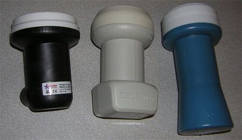

This afternoon I performed a quick comparison test of the GEOSATpro SL1PLL and two popular LNBFs sold, the DMSI PLL321s and WSI ESX521. Based on the raw performance numbers gathered during a POP test with a Super Buddy satellite meter the DMSI PLL321s and the GEOSATpro SL1PLL returned very similar results and the small performance differences could be found in a batch variance. Once again, the ESX showed higher signal gains, but the increased noise reduced the carrier to noise ratio and decreased the signal quality. The ESX could be a decent LNBF if the gain was decreased.
The performance results between the PLL321s and the SL1PLL will need to be measured in real world channel viewing reports..... Feel free to add your observations and comparisons to this thread. Your testing results should provided some interesting discussions!

My brain has a lot of experience and is so full that it takes a while to process a comparison when things are not in a line. (Other people say they are getting old). I spent about 15 minutes trying to find significant differences and I could not identify any. Is this the case or am I missing something?
The other item is the ruggedness. Is that opinion or measurable at this point, between the samples?
I am, so far sold on the duals, but I am going to try the SL1 PPL that I got.
I believe that the Lifetime Warranty speaks to how we rate the ruggedness of the SL1PLL.
The SL1PLL custom case is the by far the best and robust injection molding. The case and cap have been UV tested to the equivalent of 15 years of 24/7 exposure to the sun with no failure. The static test resulted in the highest rating that we ever have documented. We pay a premium to the factory for a pre-sort on the components and extended line testing for assembly and operational specification compliance. The SL1PLL is not an off the shelf generic LNBF with a label.
Thanks for asking.... there is definately a difference! :D
There is one spec that is significantly different. I think this spec might be important to someone like yourself thats off the grid. Look at the "Current mA" column on the far right. The WSI consumes about half the power than the other two. Granted its not all that much. But when budgeting battery power every little bit counts. Other than that all three units seem to perform similarly. Brian's point about the lifetime guarantee on the GEOSATPRO gives his product the edge however.
