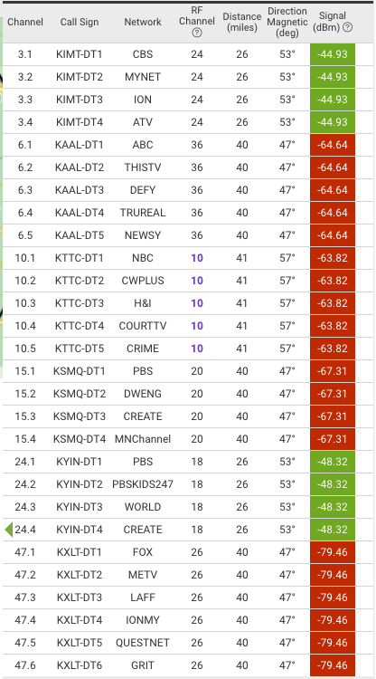

I was able to get all the stations on the attached list except for all the digital 47 channels at the bottom, which is strange because some of the other channels are from the same location but with a different tower.
I am really after MeTV with this quest as the local telephone company is discontinuing their current provider. DirecTv does not carry MeTV and only carry 8 of these local channels. Dish Network carries MeTv, but only carries 9 of these local channels. We don't want to do business with Dish Network as you don't want fees paid to the Chinese state broadcaster China Central Television which includes two propaganda channels in Dish Network packages.
Our current telephone company provider will expire on 1-23-23 and it includes all the channels on the list except for Defy, TruReal and Newsy.
Could this be an issue with these stations being blacked out from digital antennas?

Your screenshot is worthless, it's far too small to read. You need to run a rabbitears report, and post the RESULTS link in this thread. Then we can advise you properly. RabbitEars.Info

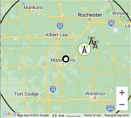

Thats is strange because if I click on the image to bring up a popup window and click on the image again I can read it on one of my 24" monitors.
RabbitEars.Info
The local KXLT stations will not show up on this tool unless you use an option that states the antenna will be at least 30 feet off the ground.

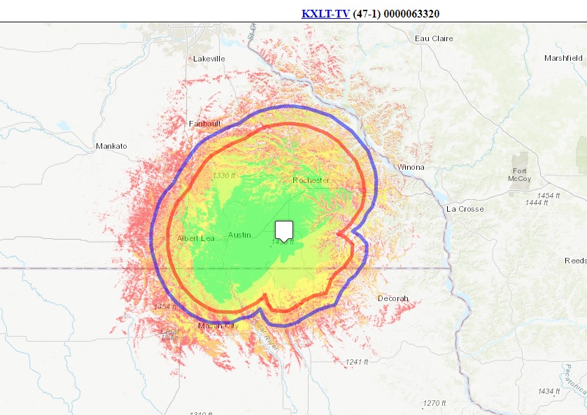

It appears from your RabbitEars report that KXLT has a smaller coverage area than your other stations and you fall at the edge of it. Replacing the flat antenna antenna with a small directional one would likely solve your problem. Mounting outdoors is always better if possible but it could still likely be placed in your attic if desired.
I have had good luck with the Stellar Labs antennas from Newark. Most of your channels are UHF but there is a VHF-Hi channel as well. I am sure others will suggest options but perhaps try this one, which is under four feet in length:

This is the reason why you can't get that solid on an inside antenna. It's 41 miles away, and "1-edge", meaning behind something tall enough that the signal has to bounce off of it before getting to you. That means it is not "line of sight".
You need a much better antenna, outside, and up as high as you can get. Click this link and you'll see: RabbitEars.Info
This antenna would be a solid choice, and would likely get that and many others very well. I own one myself: Televes DATBOSS Mix LR UHF VHF Long Range Outdoor TV Antenna (149884)
The issue with KXLT is it broadcasts at much lower power than the other full power stations that broadcast from Grand Meadow

KXLT FOX 108,000 watts 1125 feet
So while KXLT has the most height they broadcast at the lowest and also has a directional pattern
