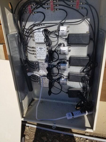

I'm trying to figure out if the MDU project I manage is getting a legit install. Some things on my project have given me doubts on whether my contractor know what he's doing
Its a MDU project, but a long string of 10 units spread out over 600 ft.
My installation is currently one DISH (not sure what model, prob. 1000 western arc)
that is split to feed 4 DPH42 switches
From the 4 seperate DPH42 switches we will be serving the 10 units, most with 3 or 4 wallys and 1 or 2 with hopper and 2 joeys.
Can the sat signal be spit into 4 before going into DPH42, and is 600 ft run way beyond the max? ( i read 140' in the guidelines)
index.php
You should be able to split the lines going into the switches so you can install multiple switches.
However some type of amplification would be required.
I obviously do more Directv then dish but the concept is the same.
You only need 1 Dish and the first thing you go into is a polarity locker which provides independent power to the dish.
From there, it will require a trunk amplifier and you split the lines before going into each switch.
Generally you amplify the main trunk line every 100-150 feet and install taps at each switch.
I hope the installer isn't putting all the switches in the main building and letting the longest run be 600 feet.

That is what is happening. only one power inserter at the switch, and then multiple cable runs for each unit up to 600 ft away, not even counting the added ft inside the building.

I dont think the Installer is very experienced at MDUs.
Is there a diagram I can find somewhere as to how an install would look using a trunk line?
The HOA may end up staying with the Dish contract, just under a different vendor. We will probably be in litigation soon.
The vendor spent 2 months installing 4 panels that look like the one I posted, and laying 1000's of ft of cable on the grounds. From the panel they have a dedicated cable for each unit, some 600 ft from the panel without any amplifiers.
