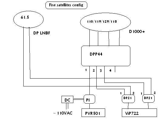

I think receivers only accept up to 5 orbitals and they all have to come through the same switches. Both the 1000.2 and 1000.4 have internal switches that accept a fourth outside orbital through the 4th LNB IN port on the LNB assembly. Usually to add a 5th orbital, one uses an external switch for the first four orbitals and cascades the 5th orbital into that stream with separate 21 switches. So there is no way to have both 1000.2 and 1000.4 dishes directly and fully hooked to the same receiver at the same time.
You cannot combine both arcs so don't worry your pretty little head over it.
yes you can
do 110/119/129 and say 61.5 on a DPP44+ switch
add 72.7 via DP21 switch on the outputs of the DPP44+ switch
or if you dont care about say 61.5 and need 77 for locals do that
so yes it is possible to combine both arcs together. Is it worth it? not really but it can be fun :)
Yep only 5 sats. If theoretically you were to want to get 5 sats (say 61.5 72.7 110 119 129) then you would need a DPP44 and a DP21.
As for which sat the receiver chooses, it's not really known, but I believe it tends to choose the eastern-most sat first. At any rate, if you were to lose signal on any one particular sat, and you were watching a channel on that sat, you would get a partial/complete signal loss message. If it was partial, and you were aimed at a sat that mirrors that same channel, you would need to run a check switch in order to get the receiver to look at the mirror.
It's very very rare that someone would need 5 satellites installed (I can't think of a scenario when you have good LOS to all the satellites). Even then, setting up a work order to reflect a 5 satellite setup is nearly impossible.
This is what a 5 satellite setup would look like
