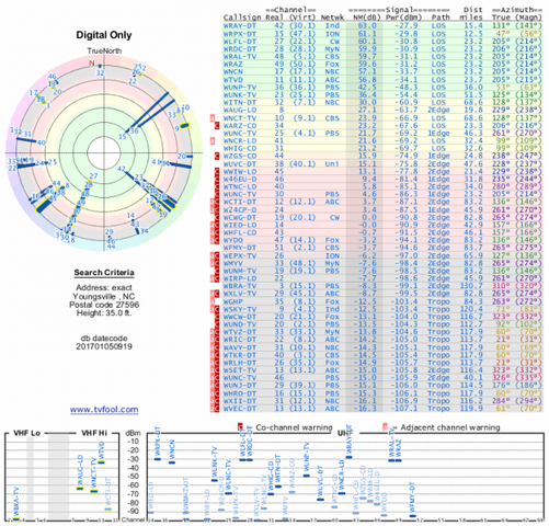

I pick up the Raleigh stations great, but I don't know if this little antenna is good enough for WITN (7.1) out of Greenville. I like to watch Svengoolie (METV) at 10 (WRAZ 50.2 doesn't start till 11 and they play Durham Bulls games a lot). I pick up 7.1 good most of the time (mostly night), but not all the time. At the time, this is what antenna I had on hand. I'm looking to see if it's worth just sticking with this antenna or upgrading to something bigger. I posted my tvfool report.
Thanks.

Your 4 way splitter is only delivering 25% of the antenna signal to each receiver, if you bypass the splitter is the signal stable?
If the configuration stays the same you might consider a 4 or 8 bay cat-whiskers antenna.

Okay, so I disconnected from the 4 way splitter and connected the 75' antenna cable to only one TV (that's at least another 25' minimum). 7.1 is in and out, certainly not watchable, but is there here and there. I did this with no pre-amp and it is all RG-6 cable between 1800 and 1830hrs EDT. Last night we were watching 7.3 for almost 2hrs (it finally dropped out) through the 4-way and with a pre-amp using the Winegard antenna.
I haven't been on here in awhile and I'm sorry I have not. I was reading through the forums and read a little on the ATSC 3.0 somewhat in the process. I hope I don't have to re-do everything in a couple years...lol.
Do you have the antenna on a rotator? Station 7.1 is 77 degrees from Station 50.2.
You may have co-channel interference, when you removed the 4 way splitter you increased the signal strength and increased the signal of any interference.

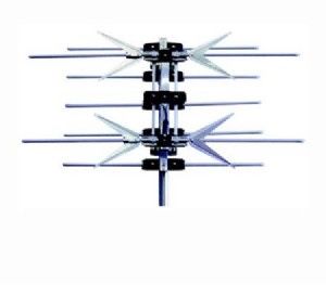

Are you turning the rotator to get 7.1 at 77 degrees from the main stations you are possibly hitting a null on the Winegard. Thanks for the picture of the HD-1080 it confirms the fact I have 2 of those and for a small antenna they are great. At 68.6 mi. from the broadcaster you are pushing that antenna, I thought I was doing good at 63 miles from my broadcasters.
Yeah, I turn it toward 7.1. I think that little antenna works great myself. I have to say I was surprised it was doing what it was doing that far out. Would you recommend a pre-amp? Or am I to close to other broadcasters?
Without the LNA 200 pre amp. 7.1 was digitizing? That pretty much indicates the antenna signal is too weak. You need both VHF and UHF reception so the suggestion is to get a larger antenna. Seeing you like Winegard try HD7694P it is much larger for the VHF section but will probably work for you.
A preamp will probably kill your local stations with too much signal.
Yeah, it was digitizing. I tried it this morning (I re hooked up the 4 way last night) and it was digitizing with no pre amp and after the 4 way. Any recommendations for an antenna. Or is it worth doing?
If you don't mind playing there are 8 reflectors on the back of that antenna, fold 4 up and 4 down so they no longer block signal from the back side of the antenna. Aim the antenna at 7.1(CH32) and see how good/bad the Raleigh stations come in. Play with the positioning to see if there is a sweet spot where they all are acceptable.
