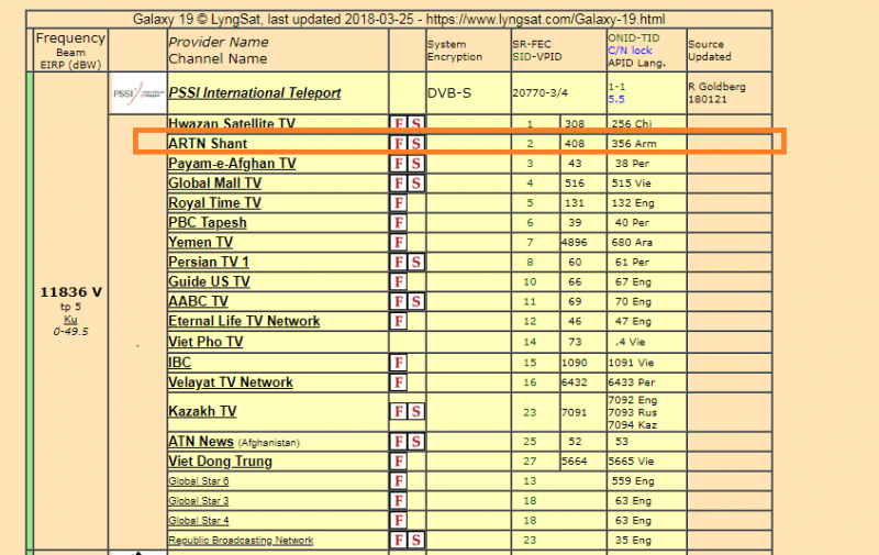

For example for the ARTN channel I tried setting a new channel at 11836, Vertical, Video 408, Audio 356 and PID 408 and when I go to that channel which gets added to the end of my channel list it says no signal. Why aren't they on blind scan? Do I have to move around my dish to find it? My signal is 83 and quality 56 and I get about 200 channels, just not sure why I don't get these 2.
Showing Color Bars on ARTN 11836 V 20770 VPID 0190 APID 0164

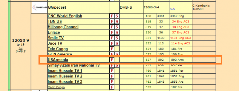

USArmenia is there 12053 V 22000 VPID 0250 APID 0251

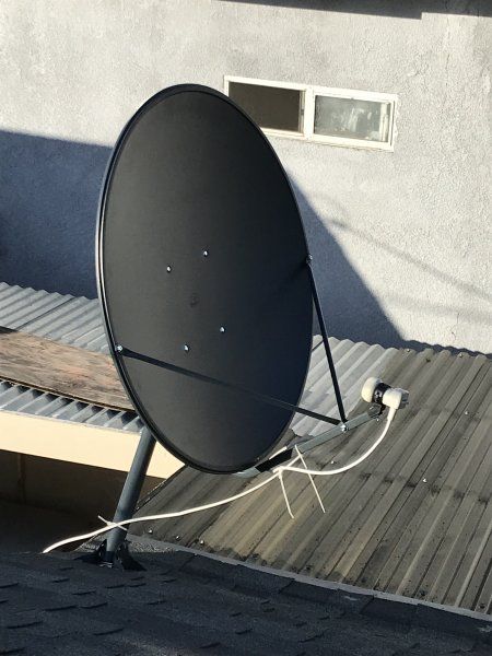

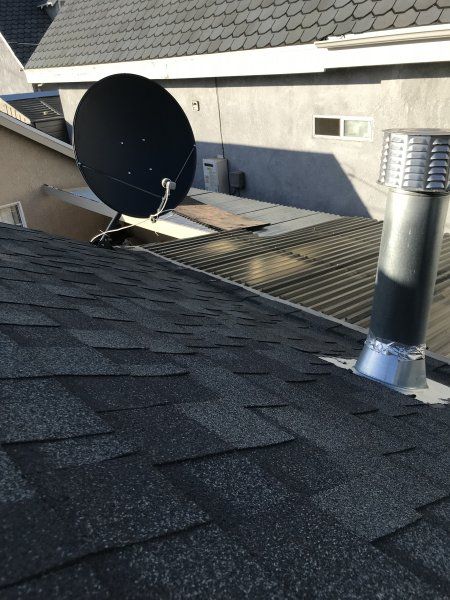

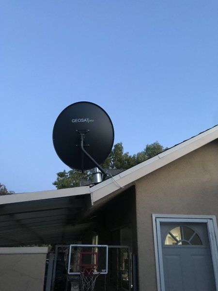

2B414BB4-07E4-4555-B50B-C2D91D8FC0DB.jpeg F70F9ED2-0132-453B-92E2-6609DAFDB421.jpeg I'm using a manhattan RC1978 and geosat pro 36'. I hat to bring my dish elevation almost all the way down to get the signal. There are also some trees there but I'm also abel to scan 200 channels.

View attachment 132102 View attachment 132103 I'm using a manhattan RC1978 and geosat pro 36'. I hat to bring my dish elevation almost all the way down to get the signal. There are also some trees there but I'm also abel to scan 200 channels.
Do you have your lnb skewed for 97w? Based on dishpointer.com it appears it should to be about 24.4° for Burbank, CA.
I do but I may have to get up there and double check. When looking from the fromt of the dish I had it set to anhsir below 25 to the left. What's hard to explain is turning the LNB left or right wasn't really changing the quality/strength when I had the TV up there. But it's worth checking this again.
Also the bubble level inside the poll, I could never get this exacly inside the circle but I'd say it was about 80% inside.
In California, the skew setting for 97w is clockwise (standing in front of the dish looking at the back of the LNBF). Rotating even 5 degrees will affect the Signal Quality meter reading. Sliding the LNBF towards or away from the reflector will also affect the Signal Quality meter reading. Select the transponder with the lowest Signal Quality reading and compare to a few other transponders when adjusting the LNBF positioning.
It is not necessary to center the post bubble on a fixed dish install. A plumb post is only important for a motorized install.
