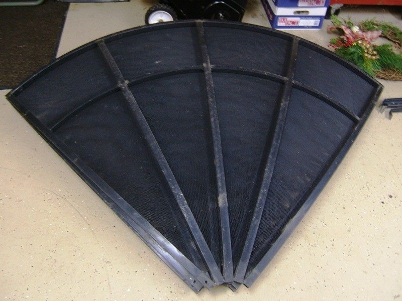

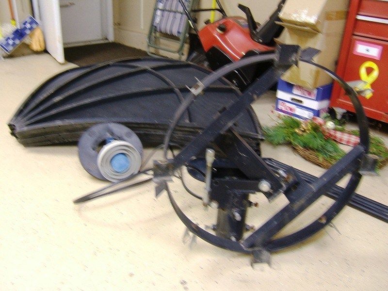

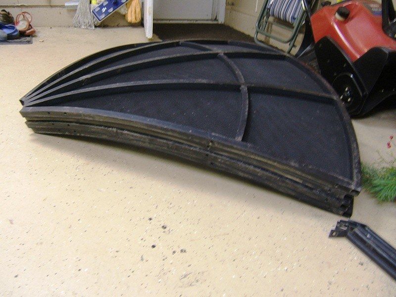

Well today I might have found a large dish that might work. I will go and take a look at it tomorrow. The drive is about 3 hours. I am not sure of the name brand yet. The older man didn't know. he says it is mesh type and is 94 inches across the dish according to the papers. He says each panel (4ea.) is 47" x 66" He bought it new and it's been in the basement for two years. He could not use it in his subdivision. He said the motor control box and actuator Arm for the dish are new and not been used. This may be just what I was looking for, hope anyway! If all goes well, I'll have it tomorrow night and let you know.

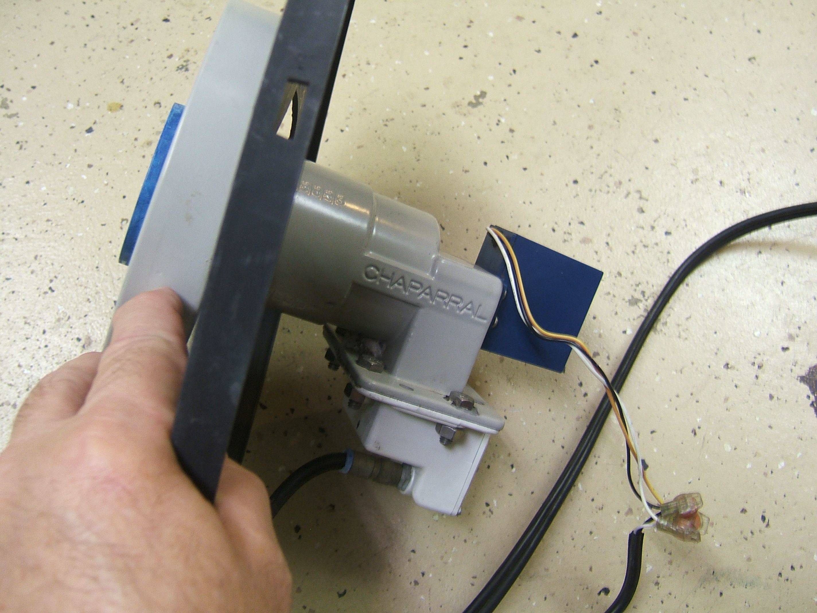

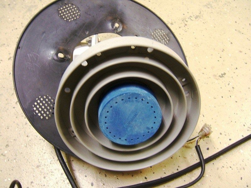

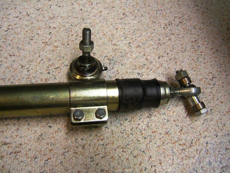

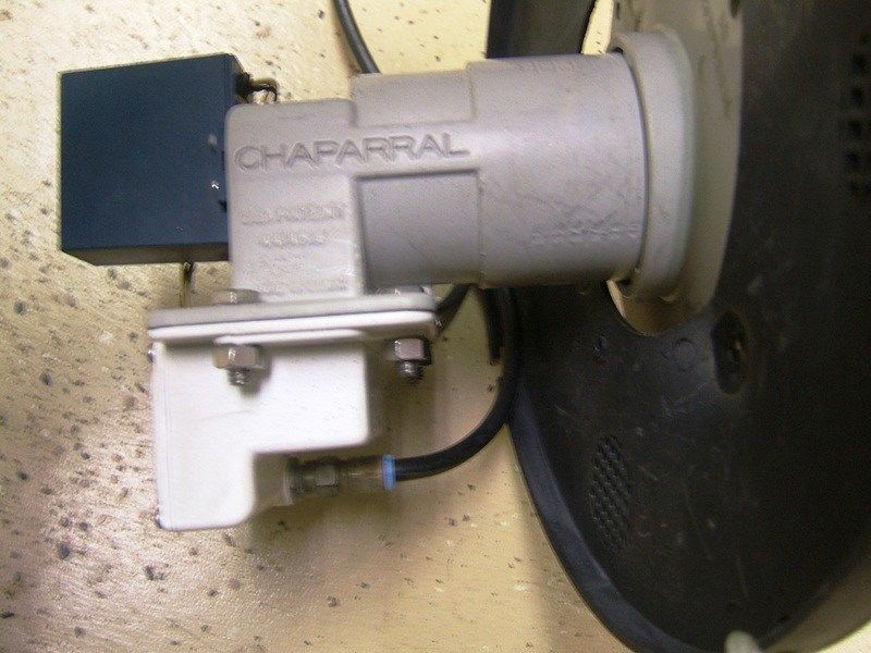

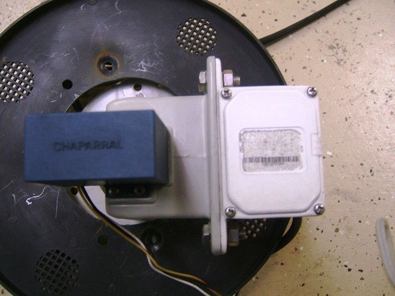

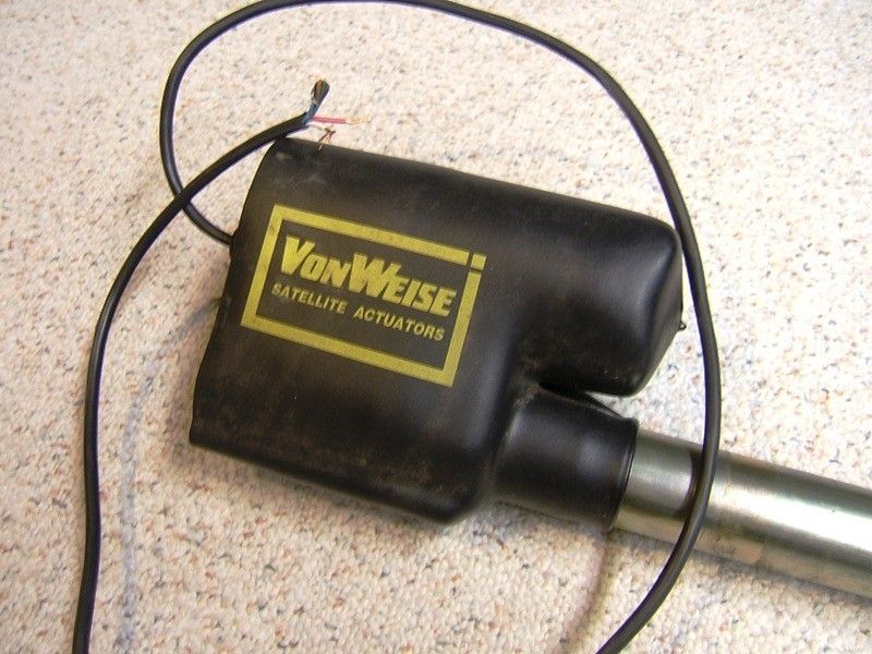

Today I picked up a fairly new 7.5 foot mesh dish with heavy duty mount. It came with a fairly new VonWeise Satellite Actuator (heavy sucker) and used Single Chaparral C-Band LNB. I don't have any numbers I an read on the LNB yet. I will have to find a magnifier and read it again. All in all, I think this was a good find. I will try and get pictures later.
Turbosat, thanks!

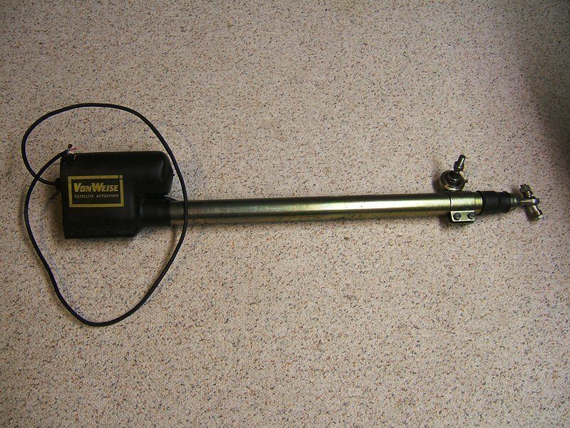

A quick update. Found the information for the Von Weise Actuator. Model V76-5, 24", 1/15 HP, 2.75 Amp, 24-36 Volts DC, SN#G1003. I think I will need some help when I get ready to wire this baby up. A lot diffrent from my HH Motor for Ku Band. (This may sound stupid, but how do I get my photos to appear under the information). Can somebody give a step by step line help for me. Trying to figure out the LNB. When I get to post photos maybe you guys can help. I'll take photos on Sunday. I am still checking all this out:).

I don't plan to get this all installed this winter so a want to take my time getting everything right. I have few questions. I plan to clean everything up like new, and wanted to know if I can paint the frame with any type of paint, of course for out doors. I want to use a brush instead of spray. I have never done this , so you experts will know all short cuts :).

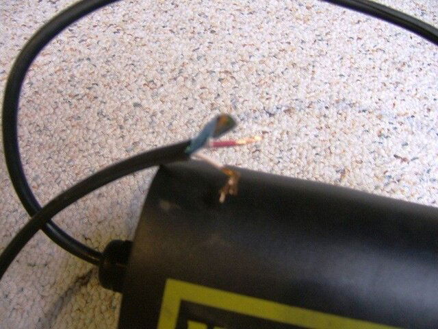

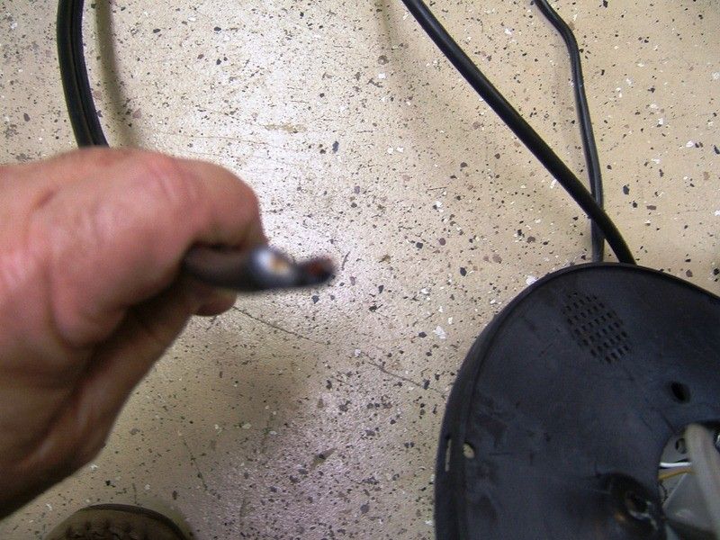

Also about the Actuator, I was told he did not use a control box. He just used the satellite box receiver? Anyway, just a few questions, there will be more.
Yes, he used the satellite receiver to control the actuator. The previous analog satellite receivers incorporated the power and control circuitry for the actuator and also the circuitry for the control of the polarotor [little blue box on the back of the LNB], which changed the skew and polarity for V or H. You will need a control box for the actuator, and also something to control the polarotor, if you use that LNB setup. Someone had a post during the past week about a polarotor controller found on Ebay. You have found some NICE equipment, Congrats! Oh, yes, the paint - you can use anything appropriate for coating metal outdoors. The only thing I can think that might be a problem, don't paint the mesh holes closed, it will increase the wind resistance of the dish. Good Luck!
