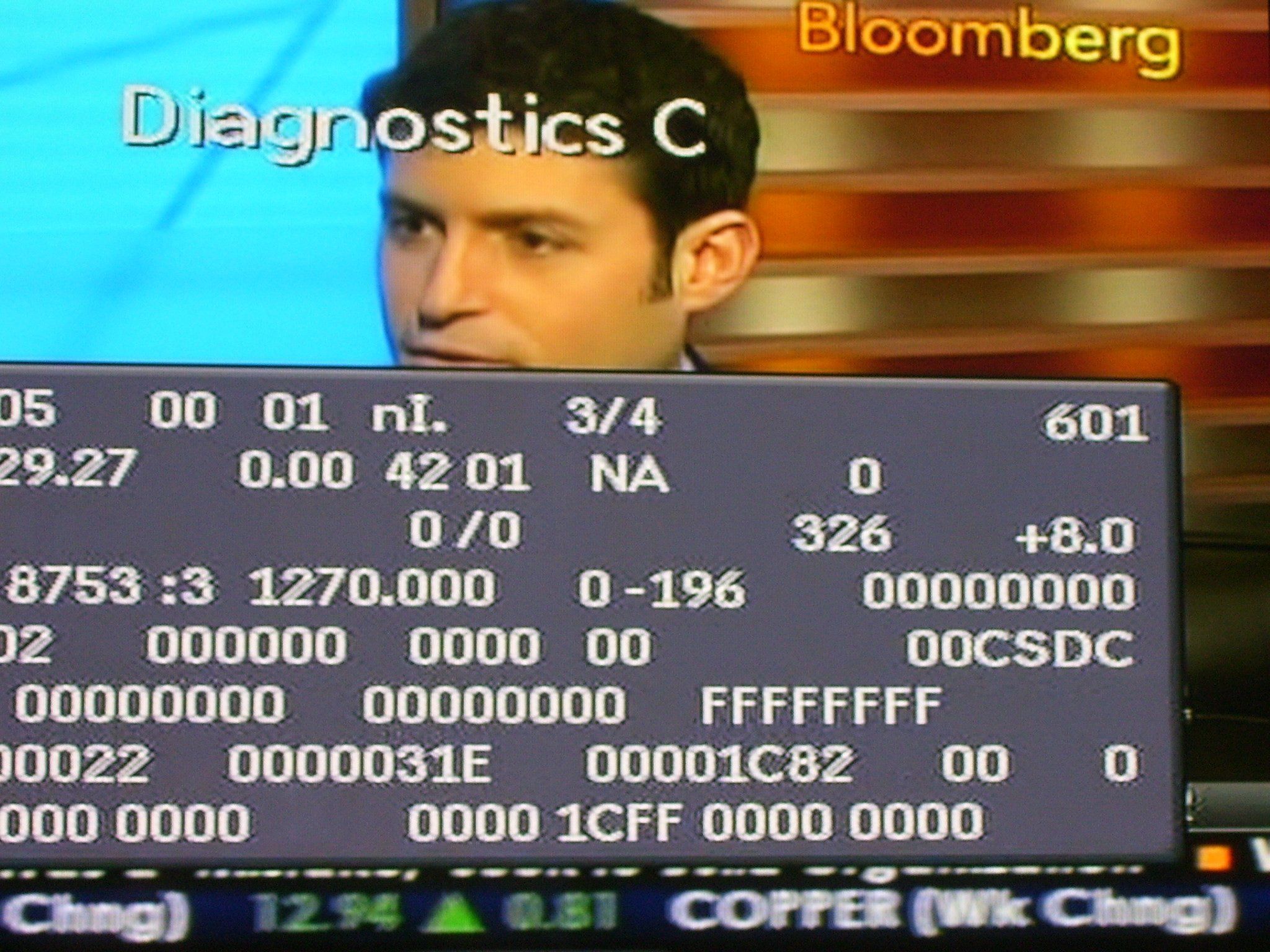

I hate to sound like a dummy, but what is ebno? :confused:
I have a 4DTV 920 receiver.
And, how do I get FTA on these receiver?
All I watch is some channels on GB, and sometimes watch the Hallmark somewhere out there.

The easiest way to explain is on a Motorola unit the ebno # would be kinda like the "quality" meter on a DVB setup
On most units its options 6-0-5 then right arrow to diagnostic C...see attached picture below
The higher the ebno, the less amount of rain fade you have. In most cases these are the "guidelines"
+3.5 to have a signal
+3.5 to +5.0 to keep a stable picture...rain fade very possible
+5.0 to +6.0 nice solid picture but rain fade is possible
+6.0 to +8.0 strong signal
+8.0 to +10.0 really strong picture
+10.0 and above....highly unlikely the signal would ever go out :)
Now I'm using the KU side of that with Starchoice. On my Primestar dish I have +10.0 and above on all Starchoice channels so I need a very bad rainfall or super duper heavy clouds to have the signal go out..
C-Band would be different. The HBO mux at 7/8 FEC would need alot higher ebno than the regular 3/4 FEC stuff that is on most 4DTV channels
